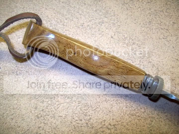

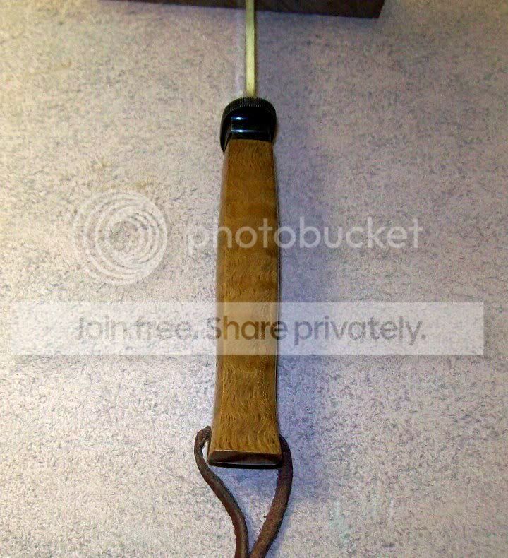

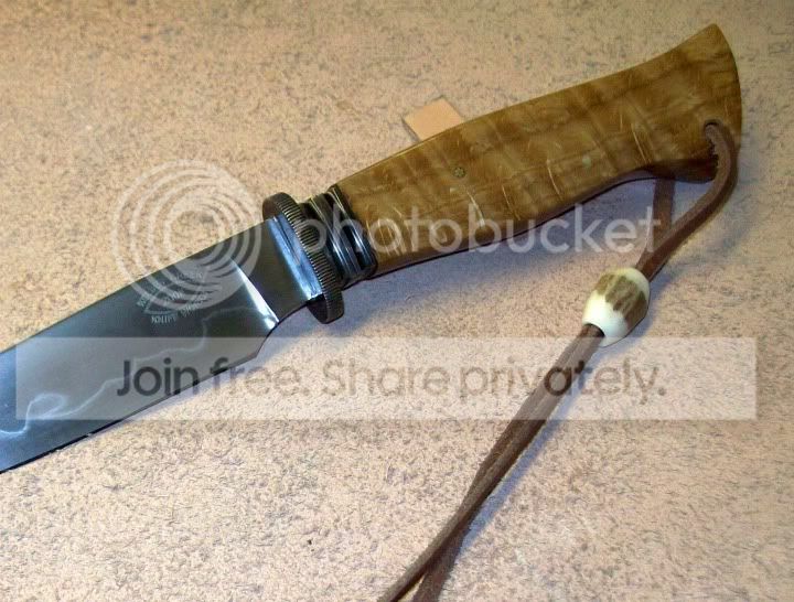

Here are pics of a knife I made using some Curly White Oak, wssi stabilized with several coats of tru-oil.
Nice tight curl to it, but subtle. Not the kind of pattern that jumps out at you. I think it's a material you appreciate more after a close look .
