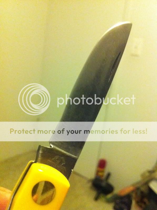

First try wasn't so great:
I ate up the heel in a hurry so it's uneven compared to the rest of the knife, though it looks like that could be sharpened out on its own. Slices my apple up nicely, though I didn't test the performance before the grind, so it's hard to say if cutting performance is improved in any significant degree.
I ground off more metal than I needed to because I forgot that there was a slight swedge on the back, which was mostly ground away as well. I'm thinking I put too much pressure on the belt because of that, causing it to flex into the heel and grind off more than I wanted. I'll be sure to correct that on my second Country Cousin after testing the cutting performance before grinding.
The D2 also takes a scary sharp edge very easily despite being a bear to grind(weird). It's a shame there isn't more of it in a cheap folding package with a decent blade length. I found plenty of fixed blades for around $50, but not much for folding knives for less than $75. My best bet seems to be the composite kershaws in CPM-D2, but I personally wanted something in old fashioned D2.
