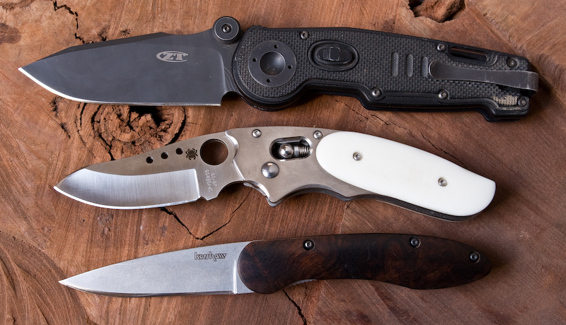

I'm spending a lot of time in places with a three inch knife rule. Trouble is that most of my knives with three inch or less blades don't really have substantial handles.
I normally like knives with the best possible blade/handle ratio, but I think I need a folding knife with a three inch blade and the longest possible handle. Other desirable features include:
Spydie hole or other blade hole opener, thumb disk or flipper. No thumb studs if possible
Pocket clip
Tip up if possible
prefer a lock other than liner lock
Any suggestions?
