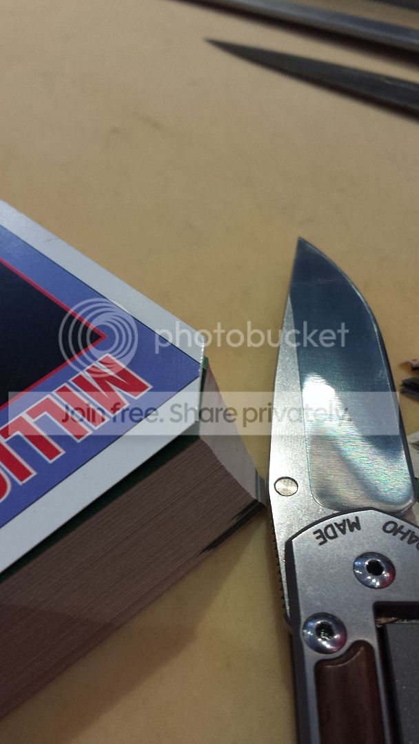

I'll have to scrounge up a phonebook somewhere and give this a try. I tend to sharpen my knives of they can't cleanly slice paper. I sharpen most to where it will shave my forearm, and if I have more time/am bored, I'll go until I can whittle a few pieces of a beard hair. Admittedly, I've never tried this trick, so I'm not sure how one of my edges would compare.
Looks fun though.
when i first got an edgepro, i went crazy with mirror polished edges. i was cleanly slicing toilet paper, anything. but i never really found a need to slice toilet paper and for general use i didn't want to use them because of the work involved in getting that edge back. now i'm happy with a medium to fine diamond finish and a few passes across an old loaded belt.
[video=youtube;ZGGH99CytV8]https://www.youtube.com/watch?v=ZGGH99CytV8[/video]
So lets see your video doing it
Why should he have to prove anything to you? Lol!
It really doesn't take much to make a knife sharp. It takes about 10-20 minutes to make an edge carve hair...
