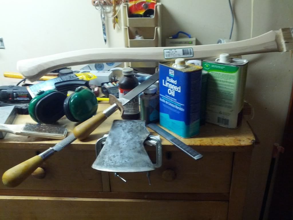

The Kelly axe I'm going to be working on is pretty clean. I vaguely recall that I used a wire wheel to clean it ages ago and then greased it up before wrapping it up in foil, plastic and then duct tape. Wish I had a good vise to work with. I've an old B&D Workmate and had been thinking about how best to secure an unhafted axe head for sharpening. Will get some lumber and see what I can come up with.
Workmates can be pretty good vices. If you need thicker jaws just drop some dogs in the holes in the top and throw a couple thick boards down.

For sharpening I would just clamp it to the top of the workmate. Thats what I did this winter when it was to cold to use the garage.

Figured I'd snap a picture of how I do it since I'm currently filing up a head to haft. Folded up paper towel in the eye to prevent the clamps from marring the inside of it. Simple, cheap setup and the head is immovable from the desk...
:thumbup: I kind of wonder if clamping like that couldn't be used to take dents out of a eye. I hate it when I come across those DBL bits that have been beat on.
