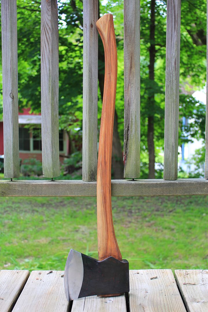

Octagonal Handle, Jersey Head Finished - Picture Heavy

Beautiful job hanging that axe Skog! I have recently come into a double-bit that has been in my family for some time, no idea of make (other than a B-7 mark, so I'm assuming a sticker was on it originally) but I'd really like to re-haft with some quality hickory, as Great-Uncle Bill always took pride in his tools. What is this handlehouse you mention in your original post? Thanks for any info!

Skog,
what do you think of the octagonal handle shape?
is it comfortable?
fine looking axe btw.
buzz

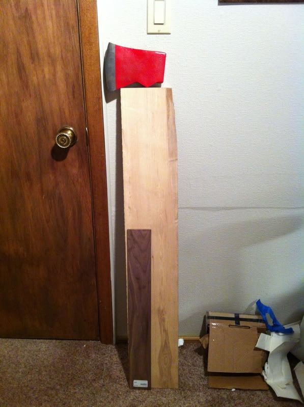

Well, that's all the motivation I need to get started on this.
I just got a nice piece of ash for the handle and some walnut for a nice contrasting dark wedge.

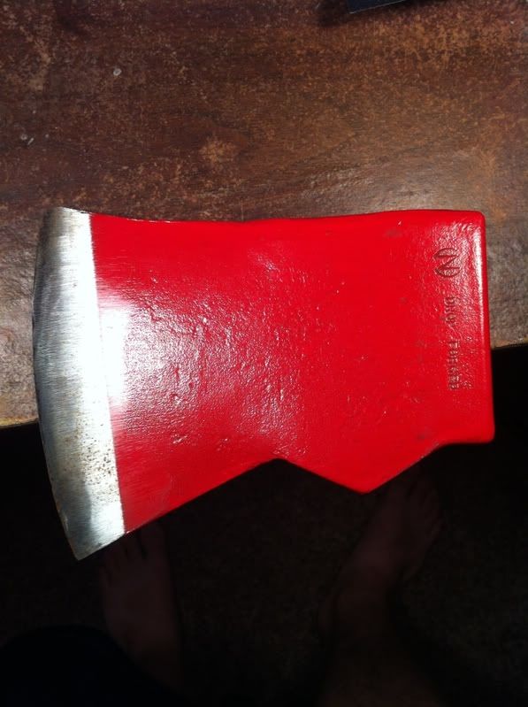

You should get out there and start chopping. I'd like to know what to expect with these mysterious circle N axes. I hope they are of decent quality since I'd hate to go through all the trouble of hanging it and it not be a performer. That handle looks absolutely awesome. I haven't decided between and straight or curved handle on mine yet, but that beauty sure makes a solid argument to go for a curved handle.
I got the same axe head, but no Circle N...however it was highly rusted on the poll....I ordered a AA grade 30 inch House Handle with octagon shaping....It will be my truck axe........I carry a 2 pound head on a 31 inch handle for back country.
the N is actually just barely there and this is a perfect head...edge retention weight and cutting edge length....At 6'8 320 pound that 30 inch handle shucks chips like a chainsaw
