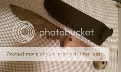

So im trying the cold blue and bleach etching technique as we speak. Ive patterned the 9 and a custom. fingers crossed. The pic is of the blade submerbged in bleach. I will update with finished pics
The 9 and the 11 are still soaking but the custom is out, and after some sanding (it creates a rust coating over the blue) it turned out like this. im very psyched about this. as you can see the patina is "etched" into blade and is permanent. Ill post up the 9 and 11 when they come out.

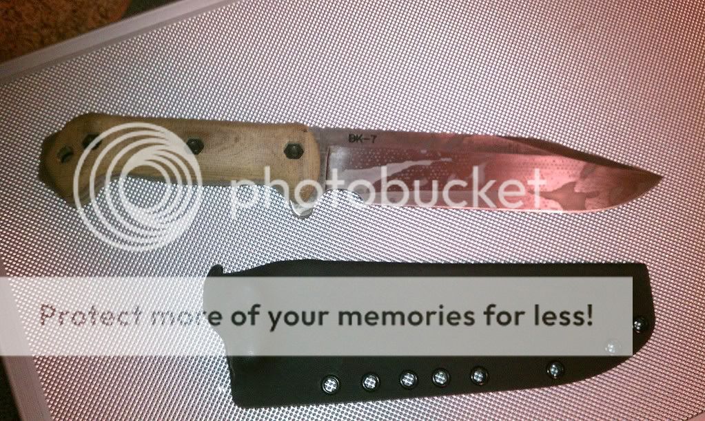

ok here are the 3 i did today. they look awesome with the 11 being my favorite. the 9 was too heavy in the container so the sides arent even but really when is corrosion even? anyways enjoy,

Ok heres what i did. Wash the blade, take an old sock (cotton ball would work but those are for my wifes makeup and my altoids tin so i didnt have extras) dab on blue in the pattern you want. in this case do not follow the instructions on the bottle, and let sit for a full 5 minutes (it may yellow) then drop in bleach. this creates poisonous gases so leave it out side. The longer you leave it in the deeper itll be. Each one of these was a different amount of time. The custom 20 minutes, the bk9 55 minutes, and the bk11 70 minutes.
When you take them out there will be a THICK coating of rust on em. scrape it off with a putty knife, then sand with 100 sandpaper, then 220. Then i reblue it to get the etchings darker, then sand again with 600 and up. i took it up to 1500. make sure to get all he rust off, it will hide in every crack and crevasse and it will continue to corrode if left on. Thanks for looking

I got a bunch of it off both the bay and amazon. I use the stuff alot. Keep the blue off the edge cuz it will eat away at the blue no matter where it is. If you wanna do the etching on the whole blade, tape the edge, blue it, then remove the tape before putting in the bleach. The blue wont run through good tape and the bleach wont effect your edge in such a short period of submerging without the accelerator, the blue.
Yeh it is. I was lucky it wasn't in that long. On my nine I actually did it twice, first time was too short, it only had a very light etching, so i reblued and put it back in. That actually happened because of the blue/rust residue left from the first time in the bleach. If you look at the first pic with the knife submerged, you can see the blue wasn't ON the edge to start, close but not on, it was my mistake, I wasn't thinking before I dunked it again. So if you do it more than once, rinse the container and use new bleach to.
