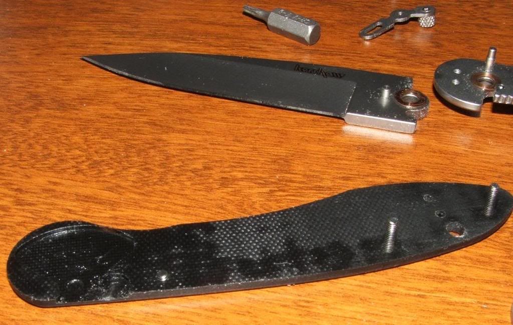

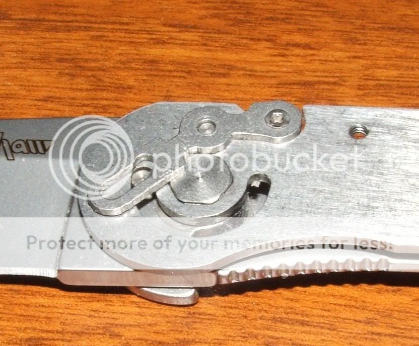

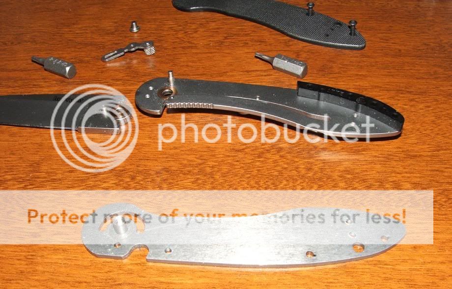

Here are some in depth photos to get us back on track. ;)
The OD-1 is a little harder to put back together than most I've worked with.
The Overdrive setup is pretty innovative to say the least.
Lots of pieces. :D
G-10 actually has a cutout for the mechanism.
Lining everything back up.
Completed except for the G-10 scale.
I took it apart twice, the second time was much easier.
Got everything cleaned up, pivot adjustment and good as new.

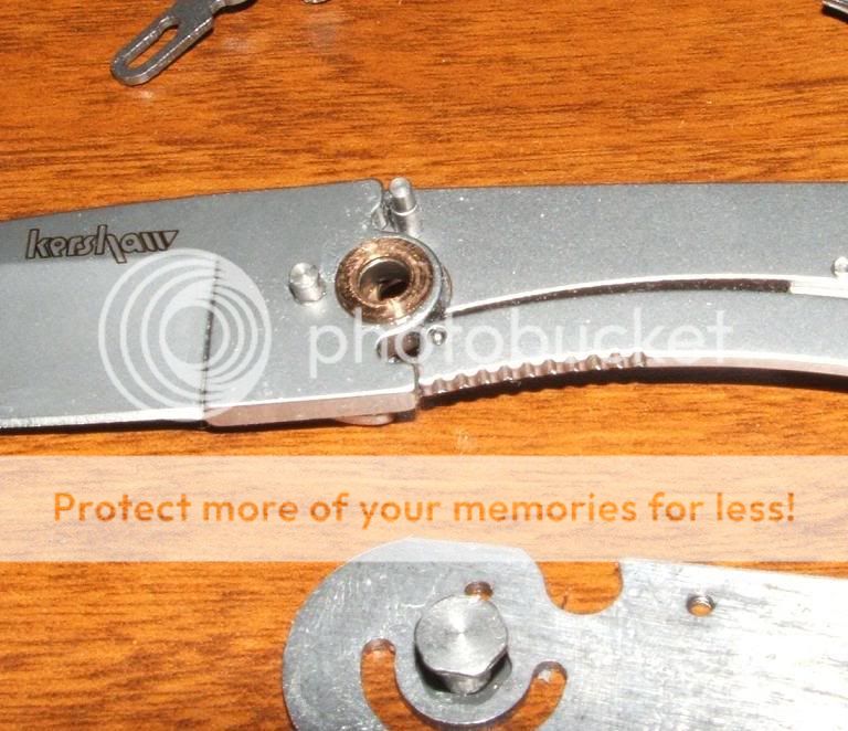

Mike, thanks for the pics. In the bottom one, it doesn't look like enough of the blade stud sticks up enough to catch the flipper. Camera angle?
It does Brad. It all comes together nicely when assembled.
In that pic, it is not fully assembled as the pivot screw is on the back side and wasn't installed yet.
sorry, didn't do the in hand pics.
