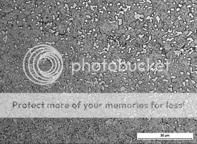

maybe the carbide size is where my confusion comes in. i've been under the impression that the black dots in these micrographs were the carbides, and s30v had smaller but more carbides based on the cpm process...
154cm
s30v

It's more about the amount of excess vanadium in the alloy, and the relative size difference between vanadium carbides and the steel grains in the matrix. The excess vanadium will still tend to collect together to form carbides of larger size than the surrounding particles of steel. In comparing these two steels, there is little 'excess' vanadium in the 154CM alloy (the little bit of vanadium found there is said to be only residual, according to Crucible), so there will be much fewer vanadium carbides in the mix, almost nil. Where the vanadium carbides are found, they will still be of larger size than the grains of simple steel in the matrix. In the case of S30V, there's a huge amount of excess vanadium, which means a much greater abundance of the larger vanadium carbides in the matrix.
The CPM process is known to refine the grain size of the carbides themselves, as compared to the carbides in non-CPM steels. But, not all S30V is CPM steel; there's 'S30V' and 'CPM-S30V'. For a more direct comparison of carbide size and distribution, it might be better to compare CPM-S30V to CPM-154 (same elemental makeup as 154CM, but utilizing the CPM process). OR, compare between the non-CPM versions of both (the standard 'S30V' vs. '154CM').
