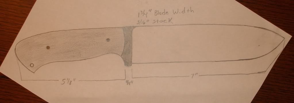

Ok, new 9" bladed Camp Knife Drawing!

So here is what I have come up with for a camp knife. I drew out quite a few and like this one the best. The blade shape might change a little bit when I profile it but it will look pretty close. I like the handle the way it is. Its wide so I will probably use thick scales, like 1/2" so I can shape it more, kinda like a stick tang bowie handle. I need to order the steel but hopefully I can finish a couple up this month after my orders are done. What ya think?
Here it is with a little longer handle and 9" blade
Looks pretty good Bro,
Might be just about perfect.
I vote for this knife as your next pass around.
Thanks Joseph, Im going to do them full convex since I like that grind on larger knives. I just did a BK9 for a guy with a full convex and it turned out wicked sharp. I took it out to test the heat treat by chopping a 4x4 in half and it still went through paper afterwards like butter.

Looks good, big enough to handle just about anything around camp.
Speaking of kepharts, Get to work will ya! . Really no hurry bro. On that BK 9 you convexed, was that the edge or the grind.
Yeah Wilson, should be. I wanted something with a useable tip in case it was the only knife you had with you. We will see how it turns out!
Yeah, the tip has enough of a curve to use for skinning if a man had to.

7" camping knife, full convex...yep, looks perfect to me!
I have to say that looks like an awesome design especially for that POU, I would add some jimping on top for a little better traction and an extended pommel for hammering tasks
