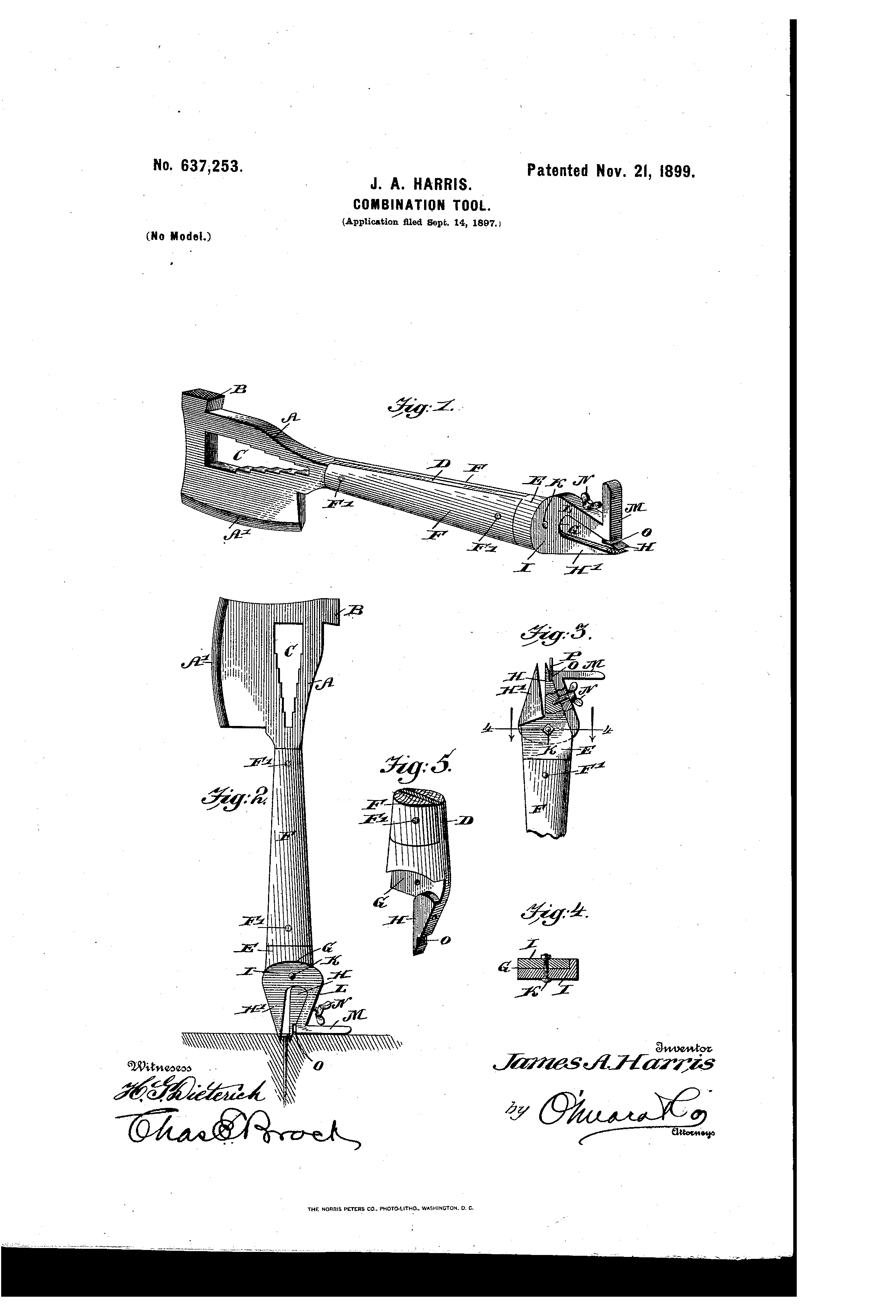

Just found more detail.
http://www.google.com/patents/US637253?dq=patent:637253&hl=en&sa=X&ei=j12WUpasMZHIsATt6YKYCg&ved=0CEEQ6AEwAQ
I'm still trying to figure out what's going on with the end of the combination tool handle???????
Its a cats paw(nail puller) that is adjustable for depth. Might work very nice for pulling counter sunk nails in a piece of trim that you would want to re-use. Note the piece of steel that will cut wood fibers so that when you pull the nail you won't splinter the wood.

It doesn't look like it would grip a nail very well - perhaps the reason it didn't catch on.
