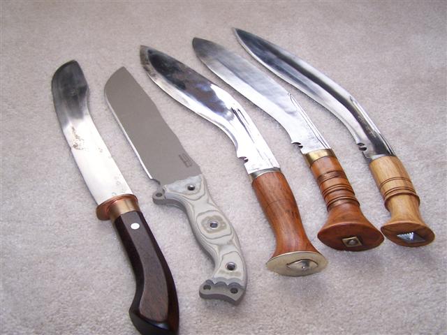

Right-most is BC:
Second from Right in this one:

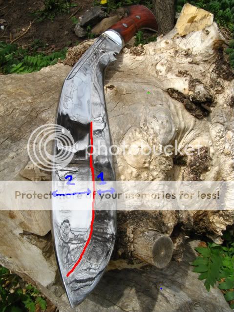

Here's what I'm talking about
(hollowdweller's) Original GK Khukuris Bonecutter - the bevel takes up about 1/3rd of the blade's width:

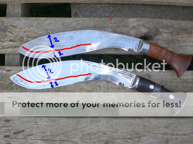

(ilbruche's) Older Sgt. Khadka - different style and blade profile, but the bevel still takes up about 1/3rd of the blade's width:

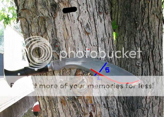

An example of the latest Bonecutters by a kamis other than Sgt. Khadka - The bevels take up only ~1/6th of the blade's width:
While these new "bonecutters" would still make great kukris in their own right, it doesn't quite fit the bonecutter's original intent: That is, a wide bellied, thick spined kukri combined with a VERY acute edge. This combination of weight and a fairly thin edge allows for a very deep bite and penetration into the target - hence the name, "bonecutter". The newer bonecutters, with their much more obtuse bevels, simply do not fit this bill...

Just reinstalled Windows 7 after some computer issues and haven't had a chance to install Photoshop back on... drew that stuff on with the built in decorator on photobucket (which was a pain).
And yeah - I've been wanting to pick up a bonecutter for awhile now and was really quite excited by all those BCs on the DotDs last week. However, I was put off on picking one up due to the changed design :(
