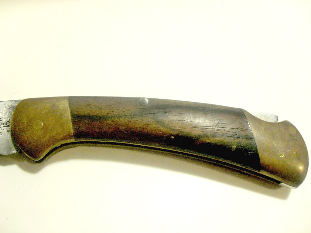

Hey all,
Came across an old Buck 112 that has a rounded body instead of the squarish type you see in newer ones. Any ideas how old? Any info?
Thanks!

There is a sticky at the top of this forum by Joe Houser with all the 112 data you should need. But, you have a pre-dot 112 three liner that's been modified with rounding of the bolsters. I can't see any inlay rivets so the wood may not be original.
1972/73 Version 3 with Sequa Wood and two inlay rivets, three line stamp.
1973 Version 4 with Macassar Ebony and two inlay rivets, three line stamp.
You likely have a 4th Version with the inlay rivets sanded off. But its one or the other. gw

Can you see any tiny pins from the rivets? The head should be gone but if its original wood the pin should remain or a pin hole possibly filled. If none of that, I'd say different wood. Its hard to tell with these pictures.
Care to try for some high resolution pics for the inlay?

Chili,
The inlay is the wood handles. I keep looking at the pictures you've shown us and I just can't see a pin. Also, the SS rocker rivet looks like it will slide back and forth. Can you push it from one side to the other?
Also, I can't decide what I really think that wood looks like.
So if you could get us a real clear close up picture of the wood that would be great. Maybe mid-day on the deck out of direct sunlight might do the trick! ;)

I looked closely at 300's lightening of the picture and I can't see any pins or filled in pin holes. The wood looks different than ebony.
It could by a mod by someone with some tools and talent for such things or it could be a in-house employee project. Buck has let employees do personal project knives over the years as recognition awards over the years so it could be an employee alteration.
In any case it looks to be really well done.
Still would like to know if the rocker rivet is solid or moves with pressure (SS pin in the wood)? Thanks g
It's hard to tell, but to me the wood looks like the older ebony that was used in the late 60s and early 70s.
If not that.....I don't have another guess.
Very unique and desirable knife.

Ok so I picked up the knife, tried pressing on the pin. Solid. Tried wiggling the wood to see if it was loose. Solid. Tried wiggling the blade. Solid. Waiting for a bit more sunlight by me to take updated pics for you all.
