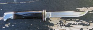

This isn't directly related to your question, but it may be of interest. The photo is of a 1961 barrel-nut 102 with leather spacers. Before the barrel-nut, a threaded pommel was standard and the pommel was rotated around the threaded end of the tang. Leather spacers could be easily damaged by this rotation so a metal spacer was used to protect the leather. If you look closely at the photo, you can see the metal spacer between the leather and the pommel. Of course with a barrel nut that protection wasn't needed. The 102 in the photo must be an early one, and the metal spacer was a carryover. Someone must not have gotten the memo about the new construction and no need for that spacer.

I'm glad you posted this. It's a rare and excellent example of one of the transition periods.
I really have a problem with the notion that file blades were worked in the hardened state, or the 440C forged blades for that matter. Annealing would be the FIRST step in making a blade from a file IMO. Forging introduces stress and irregular grain structure which much be relieved thru annealing, then final hardening and tempering after the blade is worked. I stumbled over your wording a bit but pommels were always threaded after 1951 and barrel nuts did not appear until 1961. (AFAIK ;) )
bertl bertl That 102 is just a thing of beauty.
The pommel is drilled & threaded all the way thru and you are seeing the end of the threaded tang. The pommel itself is the nut. I have a bunch of those LV knives. To get around the problem of clocking, the shaping of the pommel and handle together is completed after the pommel is affixed.

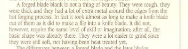

This section of the same article implies the files were pre hardened, but the early '60s forgings were not. So I was wrong about the forged blades being hard at least.

Good find. So this says the forgings were still soft and files were ground hard....still not convinced.
Well.... unlike the Pope, I'm not infallible...
I'm 14 years retired but could have had one x-rayd one back in the day to see if the pined tang was also threaded. Either the pin is antirotation or the retention itself. Was there loctite pre 1951? According to Google... invented 1953, publically available 1956.
