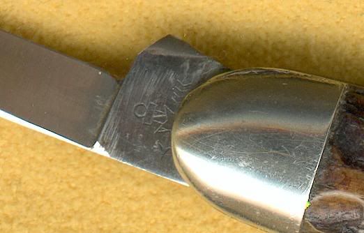

I'd like to add these dark scans,to show some details we are discussing here
This view,is looking at the tangs in the closed position & shows the long pulls cut all the way back,at the end of the blade
This is a long pull sampler shot,two NY Knife Co's & one IXL Anglo Saxon Whittler
A small Remington in where the knife maker did not break through the pull when grinding the swedge ,but came really close
It has been brought to my attention & explained,the older higher quality knives were almost always made with the pulls "open ended" at the front of the blade where the swedge is
-Vince

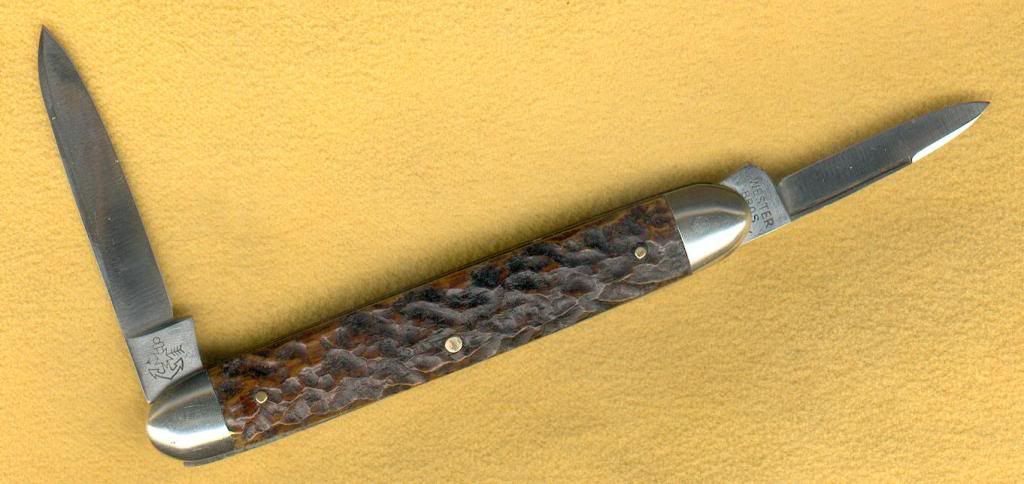

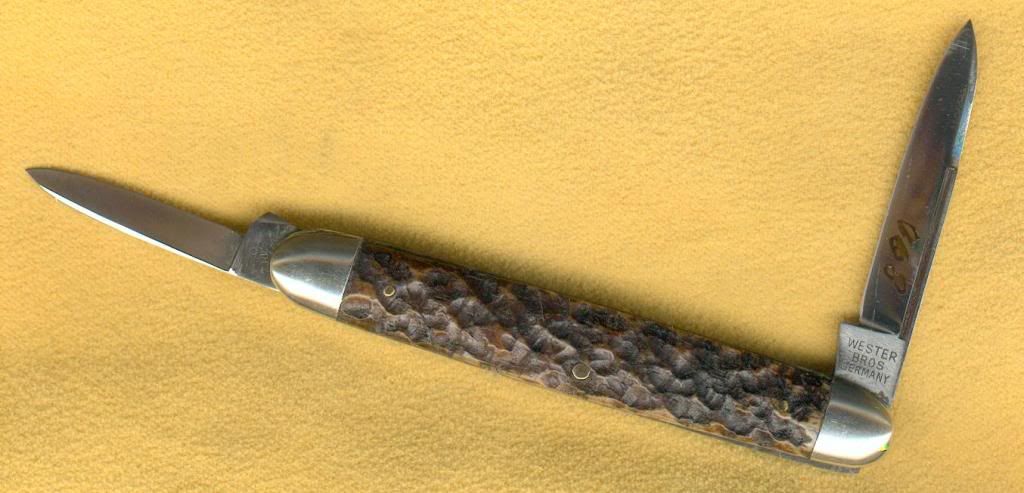

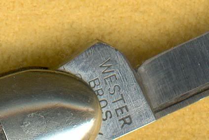

Size doesn't always matter. At a hair under 3", here's a nice little Sunday-go-to-Church knife! Nice swedges (not shown to best advantage here) that don't quite break into the nail pulls, and wonderfully jigged and dyed bone. It also has that inked number we know and love. Hammered pins and stamps on both sides of both blades tell me it's old. Does anyone know when it hails from??
Charlie,on the Wester Bros. ... Between 1890 to 1920
I'll call it a guess,educated by information.
I like the bone on it !
-Vince

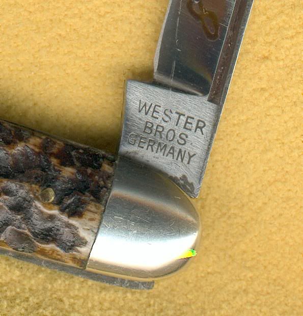

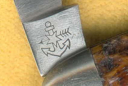

Importers of English& German knives until 1915 Spun pins on this one,2-1/2" closed
Here it is next to a worn out 3" Case knife
And here,next to a big 5-1/4" American Shear & Knife Coke Bottle
Circa 1875 - 1890
Another one of those "open ended" pulls
