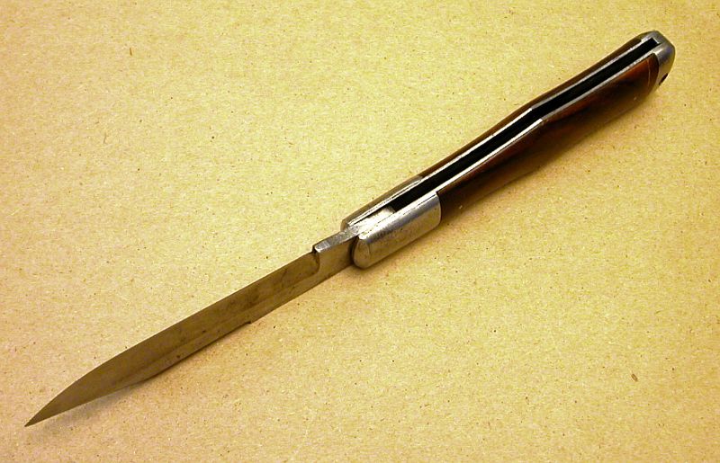

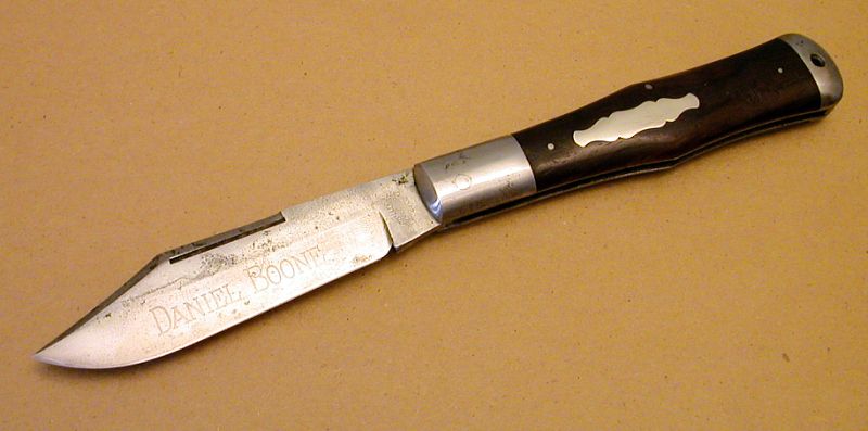

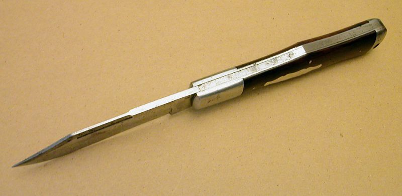

"Medium coke bottle, 3 7/8" closed, ebony scales, nicely cut n/s propellor shield, nickle silver bolsters, brass liners and pins. This is another favorite of mine that gets more than its share of daily use. At only 3 7/8" closed, it fits the hand and front pocket perfectly, and even has a half stop.Many knives use a kick to limit downward blade travel, some use a blade stop in the bottom rear of the trough made of horn, leather, fiber, or simply the soft brass center liner of a multiblade with a groove in it to contact the blade tip when it hits bottom. This and some other American Shear knives I own have no blade kick, and in this case as others, the blade edge itself actually protrudes much deeper into the pocket than does the tang. In these cases, the very rearmost portion of the blade edge only serves as the blade stop. They do not close slowly or weakly, but there is just a dull sounding snap or click upon closing. Apparently all in the proper geometry, the almost imperceptible
" blunting "of the very back of the edge never progresses more than what you see here, and this is very highly magnified so you can see it. Almost invisible to the naked eye. They made knives from about 1850 or so to about 1915; this one is about in the middle of that range and has had a lot of use, and this is all the wear to date. "

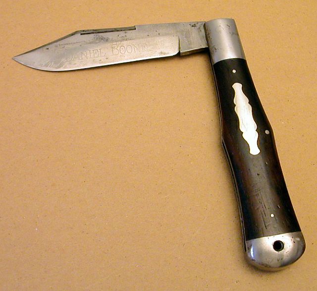

Here is the 3-3/4", alongside a typical 5 1/4" American Shear large coke bottle for size comparison. Note
" kickless" blade on large knife as well
