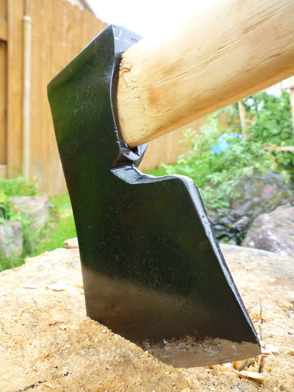

I've got the head cleaned up. It has a forge welded bit. Here are a few pics. It is interesting to see where the two metal come together on the top and bottom of the bit.

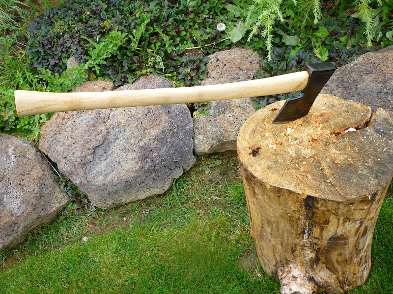

Here's some pics. This one was a ton of work. It took hours of filing to remove the mushroomed areas from past abuse. The handle also took a lot of work and reshaping to get it where I wanted it. I'm mostly happy with how it turned out. On to the pics!
Thanks for looking!
