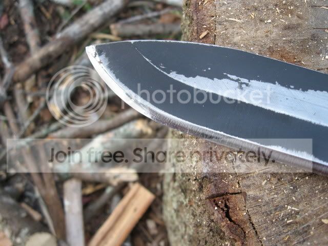

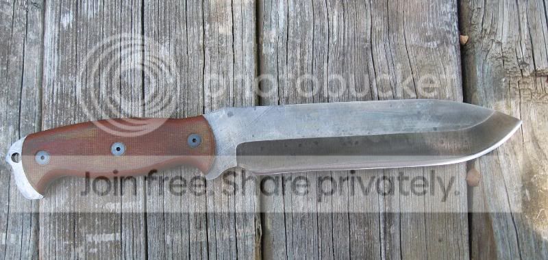

I cleaned up my old Ranger RD7 today. A lot of the coating was worn off anyway.
So I stripped it and gave it a vinegar patina. I didn't bother sanding out the old tool marks. I just left it crude.
I just love this old camp knife.
That came out good. I like the old spear point style better than the newer clip point.
Thanks, tknife. I guess this belongs in another forum, but I know a lot of the survival guys here like the big heavy "survival" knives. It is great in the yard and for camp chores. That vinegar did its thing in an hour.

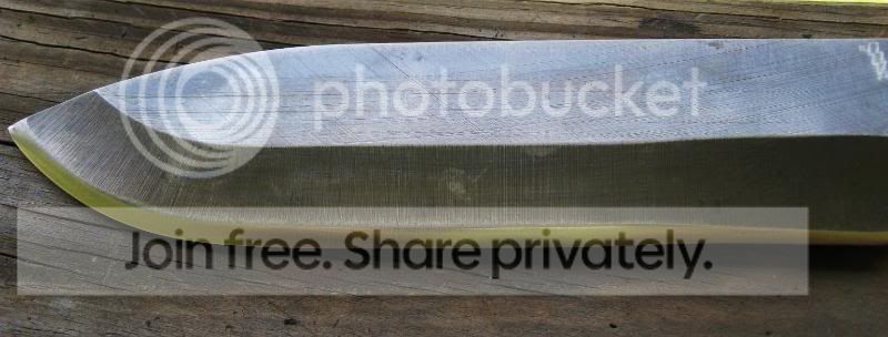

That patina is really uniform.
Did you immerse the full blade into the vinegar? I did a vinegar treatment on my opinel (balsamic - 'cause I'm a snob) by wrapping the blade in paper towel soaked with the vinegar.
With mustard, you get drying of chunky splotches that leaves a pattern to the patina probably due to higher oxygen delivery and reaction at the retreating fluid front. Sometimes you get dramatic, black splotches, but I found that these fade quickly.

Did you immerse the full blade into the vinegar? ...
I removed the scales, stripped the paint off with stripper, buffed the blade and tang with a Scotchbrite wheel. Then I immersed the whole knife in a baking pan filled with vinegar. After an hour or so, I removed the knife, dried it off, oiled the steel and attached the scales. Then I sharpened the blade on my belt sander.
