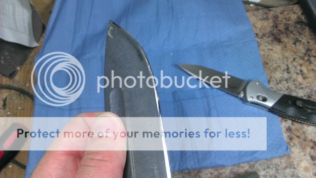

I have an Edge Pro with the Apex 4 kit; here's my results on the first try:
Second try:
