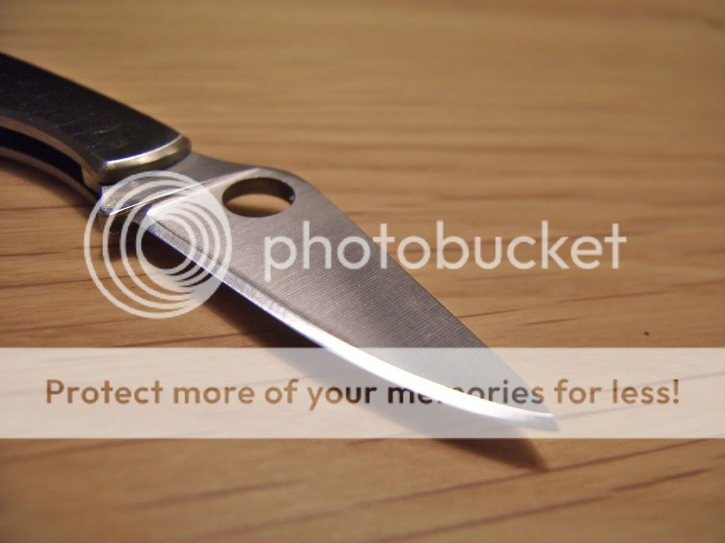

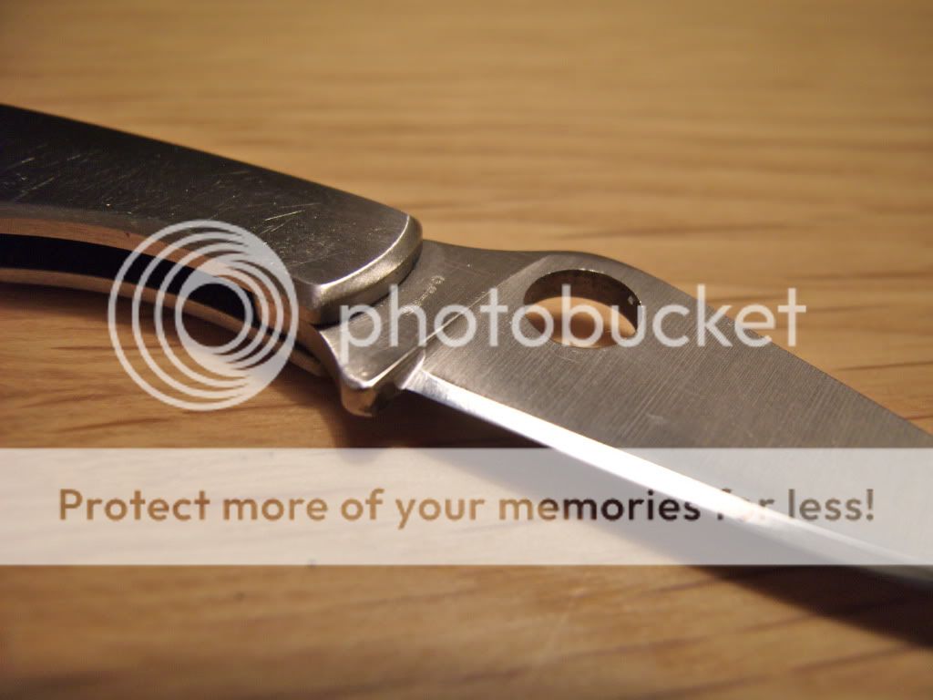

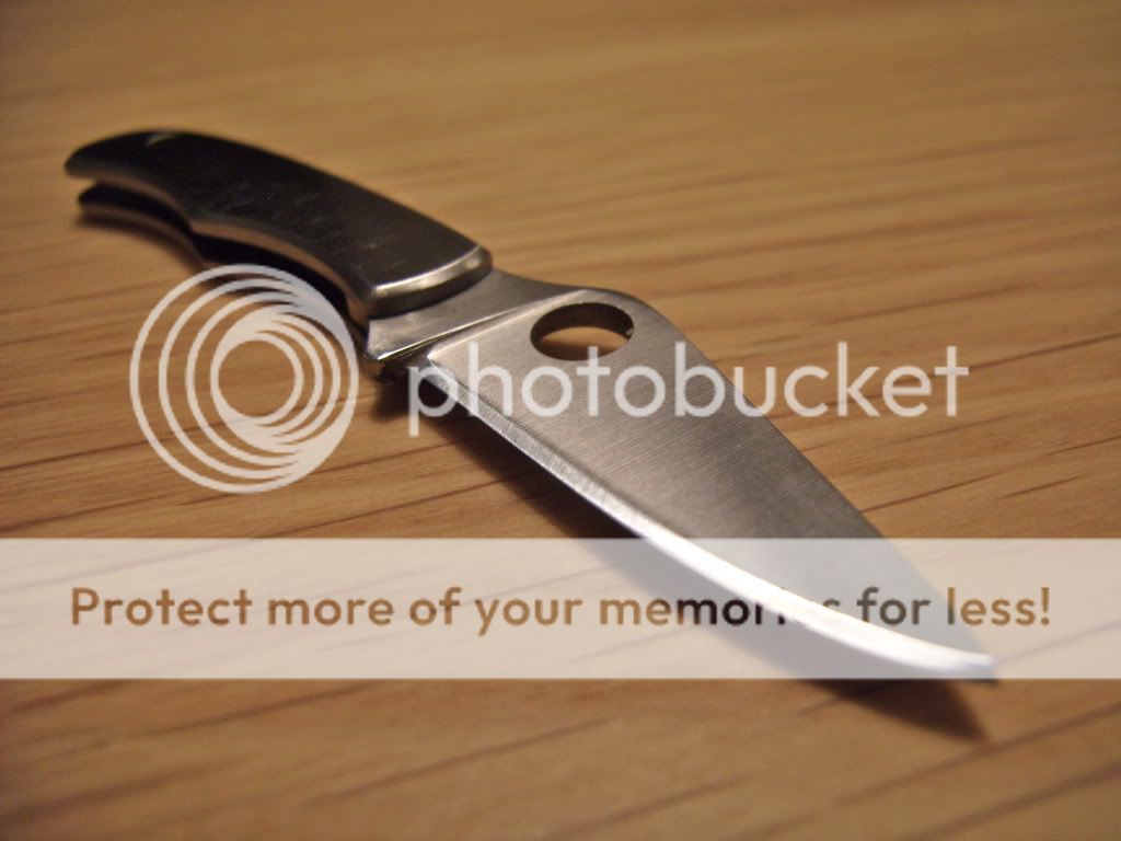

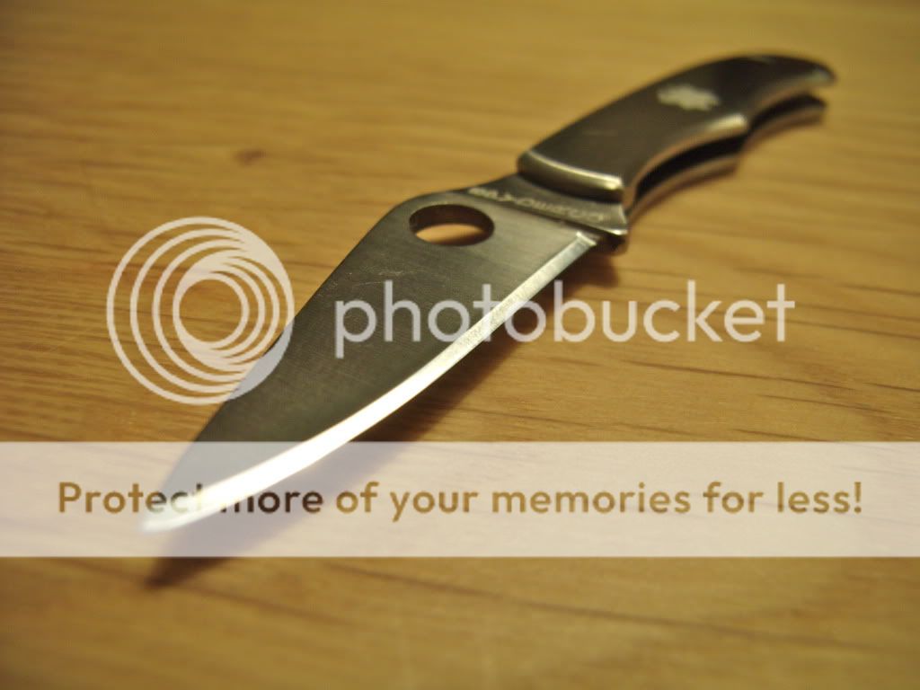

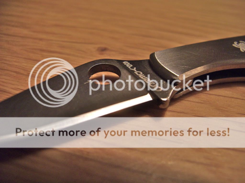

Here a Spyderco Bug which i did some time ago to show that the Wicked Edge can handle small knives well also.
The edge was reprofiled to 30 degrees inclusive with only the grit 400 & 600 diamond stones, after which the burr was removed with 6 micron diamond compound on leather: razorsharp with lots of bite.

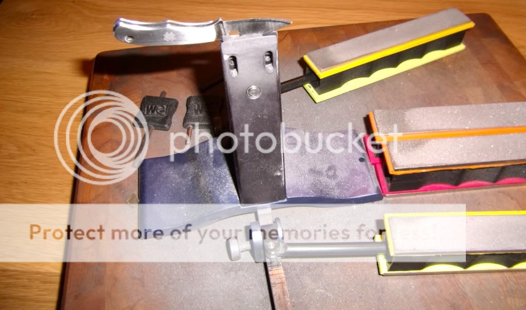

Kwackster, that edge looks really good. I understand the choils on some of the Spyderco's can be difficult to reach due to the way the stones are set on the handles of the WE. Have you noticed this? I'm pretty close to pulling the trigger on the WE, but I'm just curious.
@ FW JSB:
I have indeed noticed that, and not only with Spyderco knives.
That is the reason why i removed the plastic edges on the sides of the diamond stones so i can sharpen all the way up to the ricasso:
