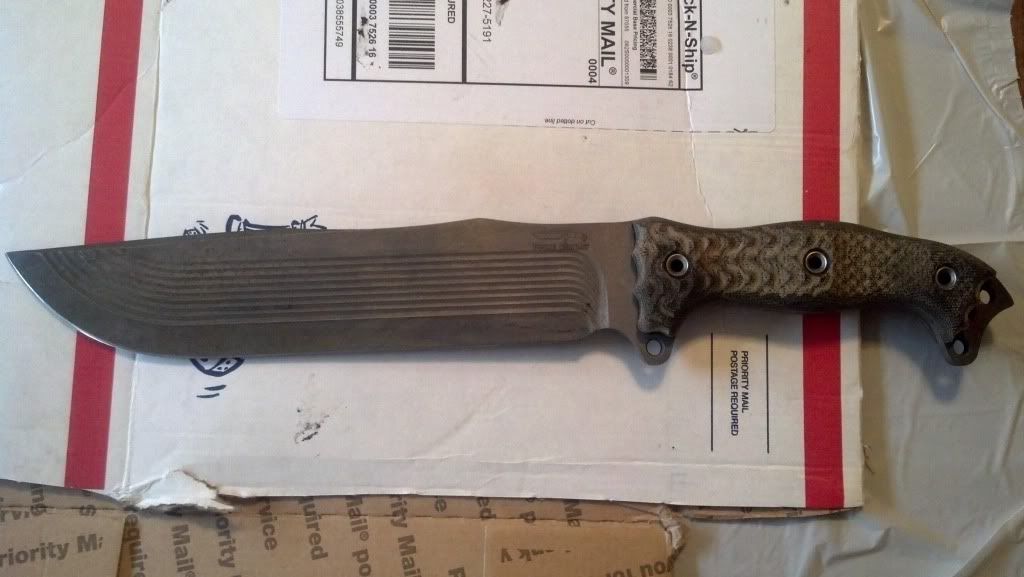

Does clean strip hurt or damage the micarta or g10 if you get some on the scales?
Nope. Many members on here have used it and had great results. I coated mine and let it sit for about 15 minutes. Then I started scraping it off. I used a toothpic to get in the corners near the handles. Then I took it to the sink to wash it off. After it was stripped I hit it with a ScotchBrite wheel.
There was a thread on stripping.....I'm just too lazy to search for it. Just remember to etch the logo if you want it to stay as out is really only in on the coating.
I used circuit board etchant from Radio Shack. I used blue painters tape to form a damn, covered the logo with the etchant and then let it set for 8-10 hours depending on how deep you want it.
Ausher. Go into radioshack and ask for PCB etchant. The coating will act as the resist and the exposed metal logo will be the only thing etched. There are plenty of tutorials if you google "how to etch a knife"
I was wondering this also. So only the Busse name is not coated and it will only etch that correct.
Makes more since now how jd4320t made the dam with tape.
