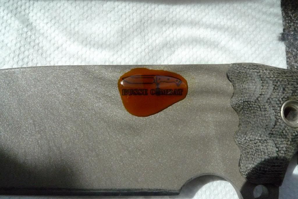

My dam is built and it's been etching for 15 min now , il keep updates
I'd start with two hours then rinse it and check it. Take note of what it looks like and feels like before starting the etch. It doesn't have to be too deep to look good. After the two hour check you'll have a better understanding of how much longer you may need to go. Hope that helps!
I see what you mean now , I rinsed it and checkd it, looks like a good start, I'm going to reapply for another two hours then strip the blade, hopefully 4 hours was enough, I'm no expert but it kinda looks like another two hours will get-er-dun

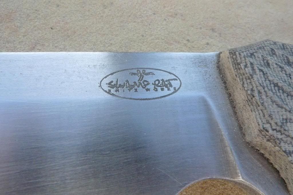

Well o well, the etch came out perfect and this knife had a surprise underneath the coating
Factory satin .. Sweet
I don't think that could have worked out better! Lookin good! Would you say 4 hours gave a good depth?

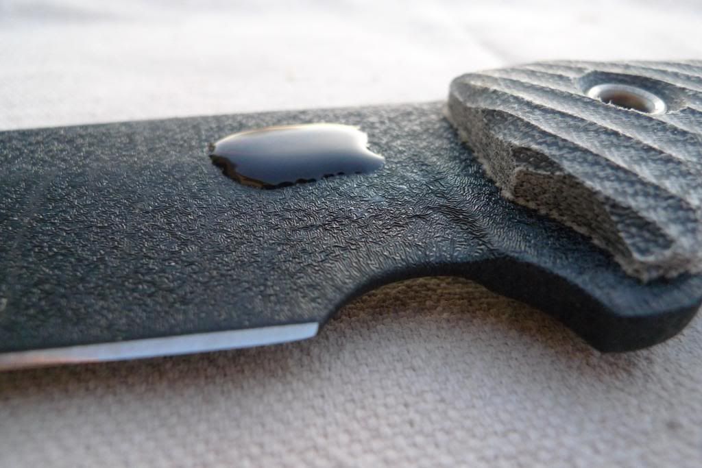

Ok. So today I'm etching the logo. Went to radio shack to get the etching solution and all they had is a 16oz. Bottle.... I could etch probably a 1,000 knives.... poked a little hole in the foil seal to put a dab on the logo and I was holding the blade and it shocked the tip of my finger! Apparently this stuff can cause a static discharge. Also I had to tape the handle because first attempt it all seeped under the handle. Is that a concern? Guess I'll wash it good afterwards.
