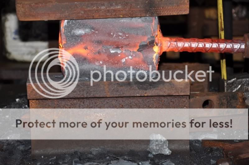

And the first press .
Chuck said:
.. and end shot of the first press. You can see the sides of the can bulging out. I want this to happen as I will remove the sides after this step.

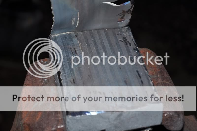

I open up the can ..
Chuck said:
.. to show the cleanly welded layers.

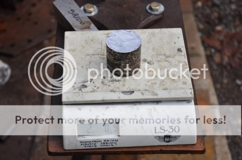

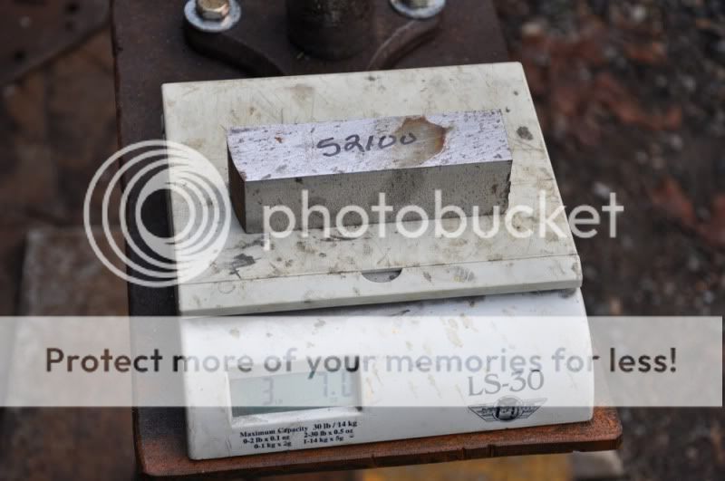

The next shot is the 52100 in bulk form. I cut this from a 6.5" dia round and re-cut it into usable sizes.
Chuck said:
Then I cut a piece of L-6 from a 2.25" round. This gives me a 2/3 -1/3 mix for the 52100/L6 mix. The L-6 is on top and ground clean. I will also grind the 52100 clean and cut and stack a 5 layer billet. Then weld it all up for the next step.
Another interesting thing for me here is about the reason behind the pairing of the steels in the mix. Why the pairing is in such a way that 1095 was paired with 15N20 while 52100 was paired with L6? Can it be done with different pairing such as 1095 is paired with 52100 and 15N20 is paired with L6 or 1095 is paired with L6 and 15N20 is paired with 52100?
BTW Chuck, is the weighing of the steels is to get the correct mix of 2/3 52100 and 1/3 L6?

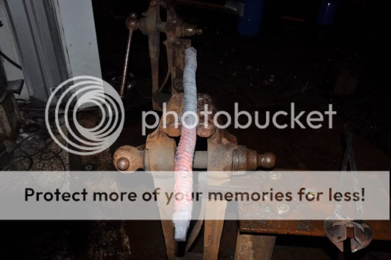

Then I twisted the bar. I attempted to do a twist on bar at 1.5" dia but it was just to hard to do. So I drew it out to 1.25" and it worked much better. As you can see I got a pretty tight twist on it.

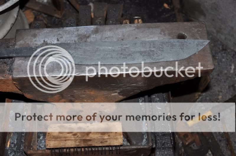

Then finally the forged blade. For reference also, the white line on the front of the anvil is 12.25". Like I said in another email, I had to use every millimeter of material to get the 2.25" width you asked for. I hope to be able to do some grinding and possibly HT this week. I do have enough to do another blade if something goes wrong but I hope not to need it for this project.
Now it looks the basic shape of the blade is already there except for the notch at the ricasso. Did you hammer it all using the power hammer Chuck?
