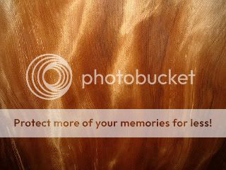

Mohd has requested Kauri. I have a piece I got that has a bit of whitebait in it. I will confirm it with him but that is the plan right now, at least for the "Big" one.
Yes yes yes! The "Little Sister" who is the "Big" one is to have a Kauri as the handle ;)
Picture borrowed from Ancientwood, LTD. Website

That ancient Kauri is beautiful stuff with a fascinating background (thanks for the link). I do have a question, though. One of the more significant factors in the future stability of wood used for knife handles is moisture content. Wood that is not very dry when put on a knife is more likely to shrink as it gives up moisture - particularly if its destination is a drier climate than the maker's shop. So how do you get wood that has spent a bazillion years buried in a swamp / bog sufficiently dry?
Roger
First let me answer Rogers question. Kauri though it has been buried in a bog for 30,000-50,000 years and very wet comes thoroughly dry from the mill. They Kiln dry it to 6% so no problems as far as wet wood is concerned.
