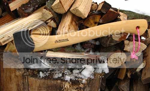

Thats a fine axe, never seen one like it before...is it good at just basic chopping, ie logs for a fireplace?
for fireplace duty, i think that a bowsaw might serve you better, but i think that the Gransfor Bruks small forest axe is a bit to short for a dedicated log cutter. maybe somthing a little longer with a heavier head, such as a hudson bay style axe.
