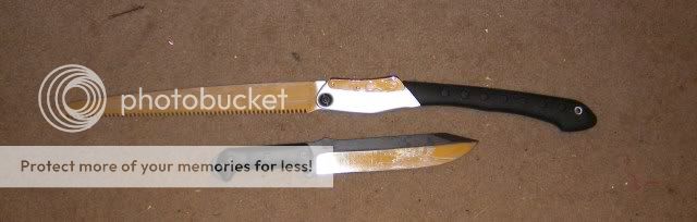

Enter Sawzilla! it's the "Big" model by silky.inc next to the Bk9 for scale
This thing is a crazy folding chainsaw lightsaber! it cuts through 8in trees in the time I can chop through a 4-5in, not to mention far less effort. I will now carry my Bk9 on my pack but this saw is gonna be right there next to it.

I thought maybe it was mustard what with all this patina jive going on here lately.
It6s a polished blade and a flash on the camera. Its is normal everyday fingerprints and with a harsh flash any fingerprint looks like that,
