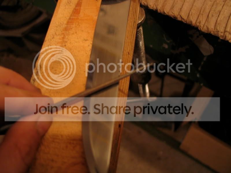

Adding some thumb serrations to the knife with a file.

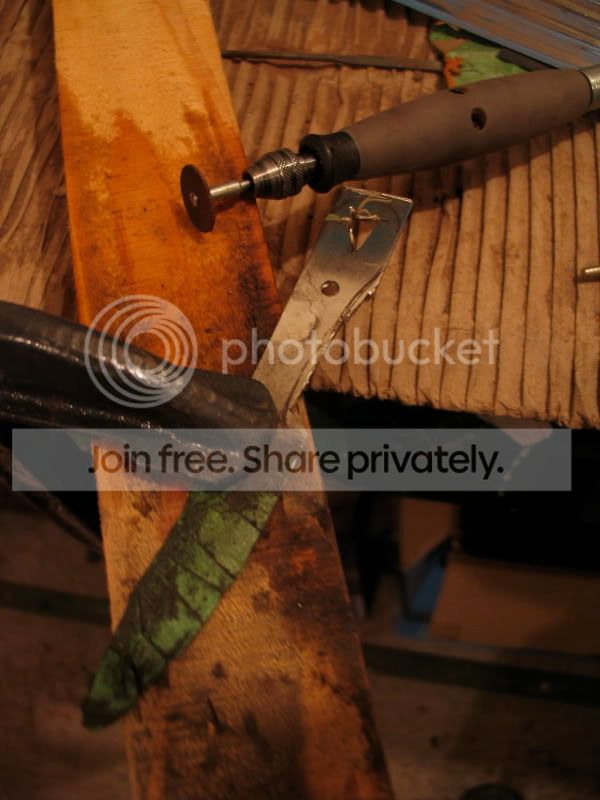

Rough shaping and drilling complete. Time to go visit the grinder and belt sander.

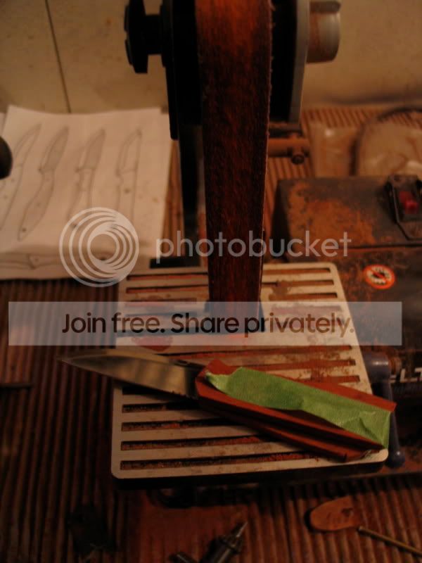

Handle material selected, cut, and drilled, with rough shaping on the front. I chose some nice Padauk, which is one of my favourite woods.
More shaping and fitting.

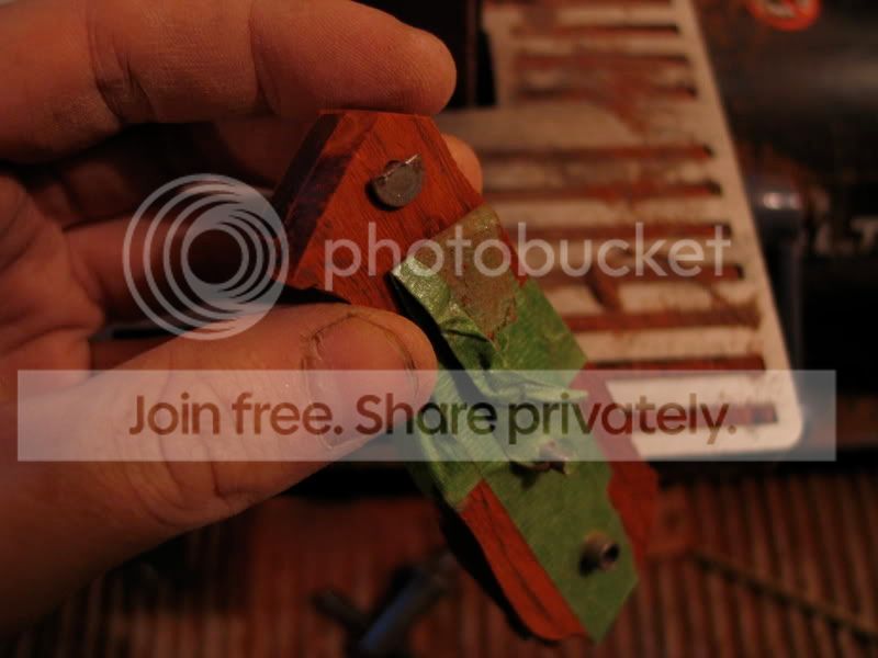

Epoxied, and rough shaping complete.
Belt sanding complete.

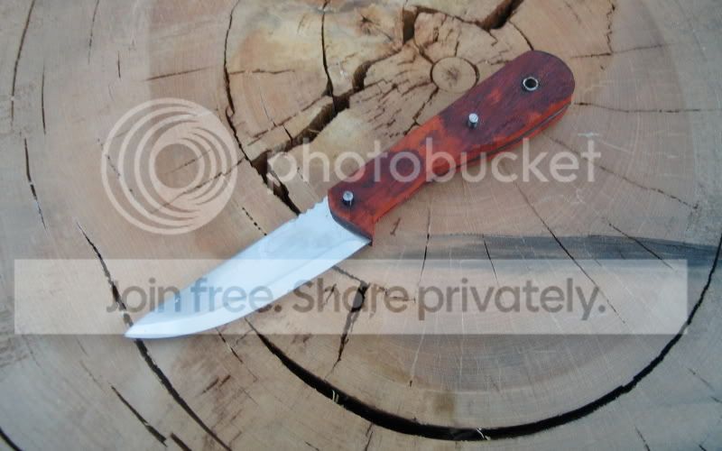

The finished product, sans lanyard and sheath. I finished the sanding by hand, gave the blade a mustard / vinegar patina for protection, and spent a few minutes on the edge with my water stones. The handle was finished with a few coats of Danish Oil. I'll probably drop a final coat or two of polymerized tung oil on it, just to be safe:
This thing cuts like a straight razor, and feels beautiful in my hand. Which is good, because I seem to have committed to using it as my EDC knife for a year!

looks like a great job, i like that wood alot. also, :thumbup: on the danish oil. my favorite wood finish
Stunning work man!! I dig padauk alot, its gorgeous stuff.
Man it looks comfy too! Great pics man.
