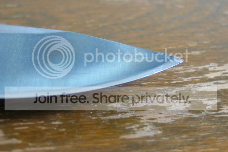

So, how's this for eerie:
For six months, I used that Delta 5 for all sorts of things, from food prep to trail-blazing. The edge held up admirably.
The other day, I decided that my trio challenge was over, and I started this thread to relate my experiences.
Last night, I used my Delta 5 (force of habit!) to cut up a trout. I cut through a few bones - nothing I hadn't done before.
- and that little task caused the edge of my knife to chip! Aargh! Six months of perfect service, but when I pull the plug on my challenge, the knife takes a dive!
Check it out - just towards the tip. It's actually rather deep. I'm going to have to re-profile the entire edge.
Anyway, I'm taking this as additional incentive to get a new belt knife. But lesson learned: If you decide to terminate a challenge, don't tell your knives! They might get jealous and retaliate.

Hey Mentor - that is a pretty tiny nick. I'd just put a micro-bevel at the tip using a more obtuse angle and that will pull it out in no time at all. Then as you pregressively sharpen the knife you'll get it all back to the same angle. You can do this in 15 min and have a great working point - as it already looks like a nice pointy point, or you can work it for an hour and a half for no real performance benefit but piece of mind that you have a constant bevel. Why do I think you are going to go for the latter???? :)
Don't sweat that nick.
Use your knife and stuff happens.
No biggie, KGD's fix will be fine :D
