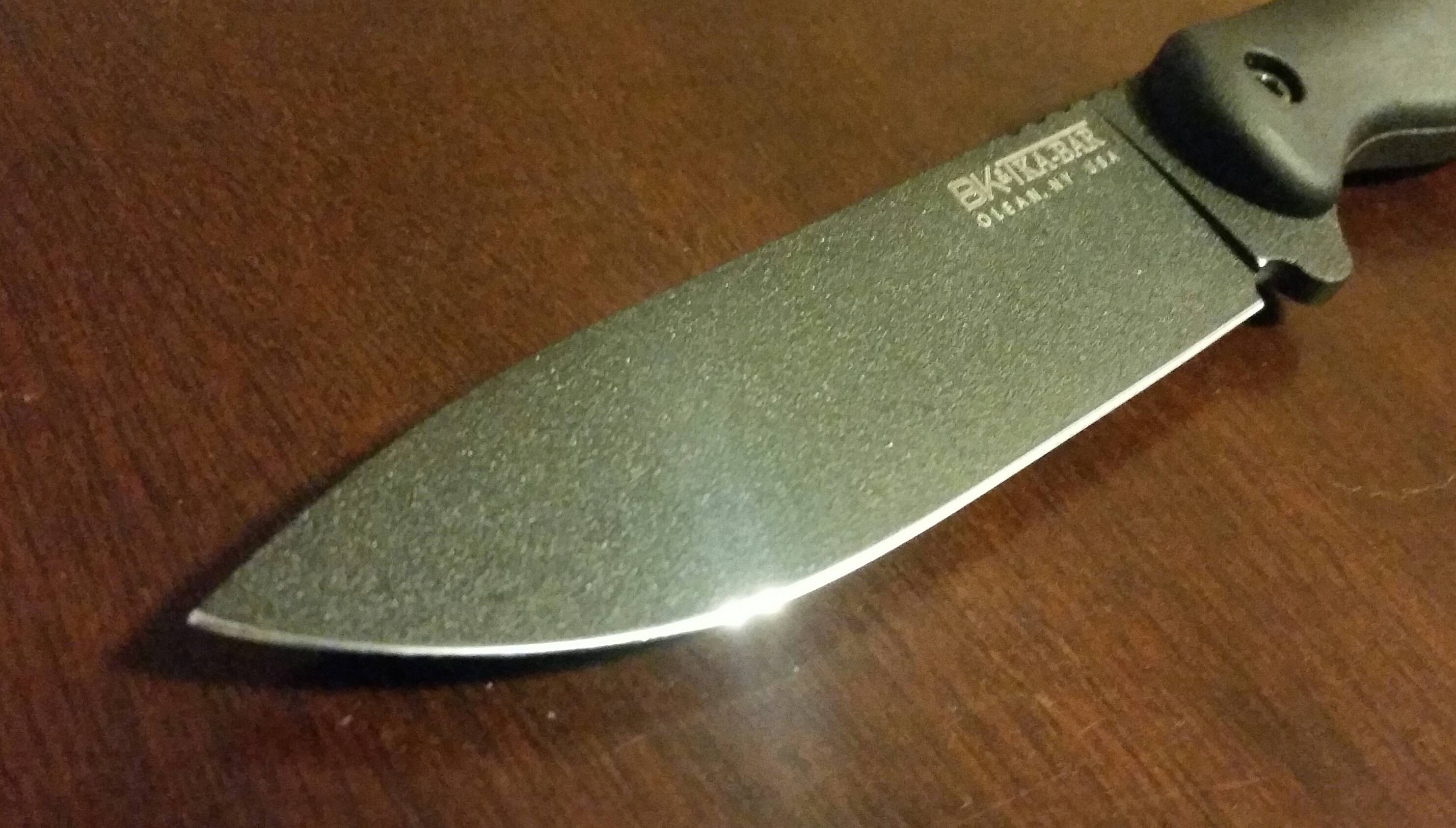

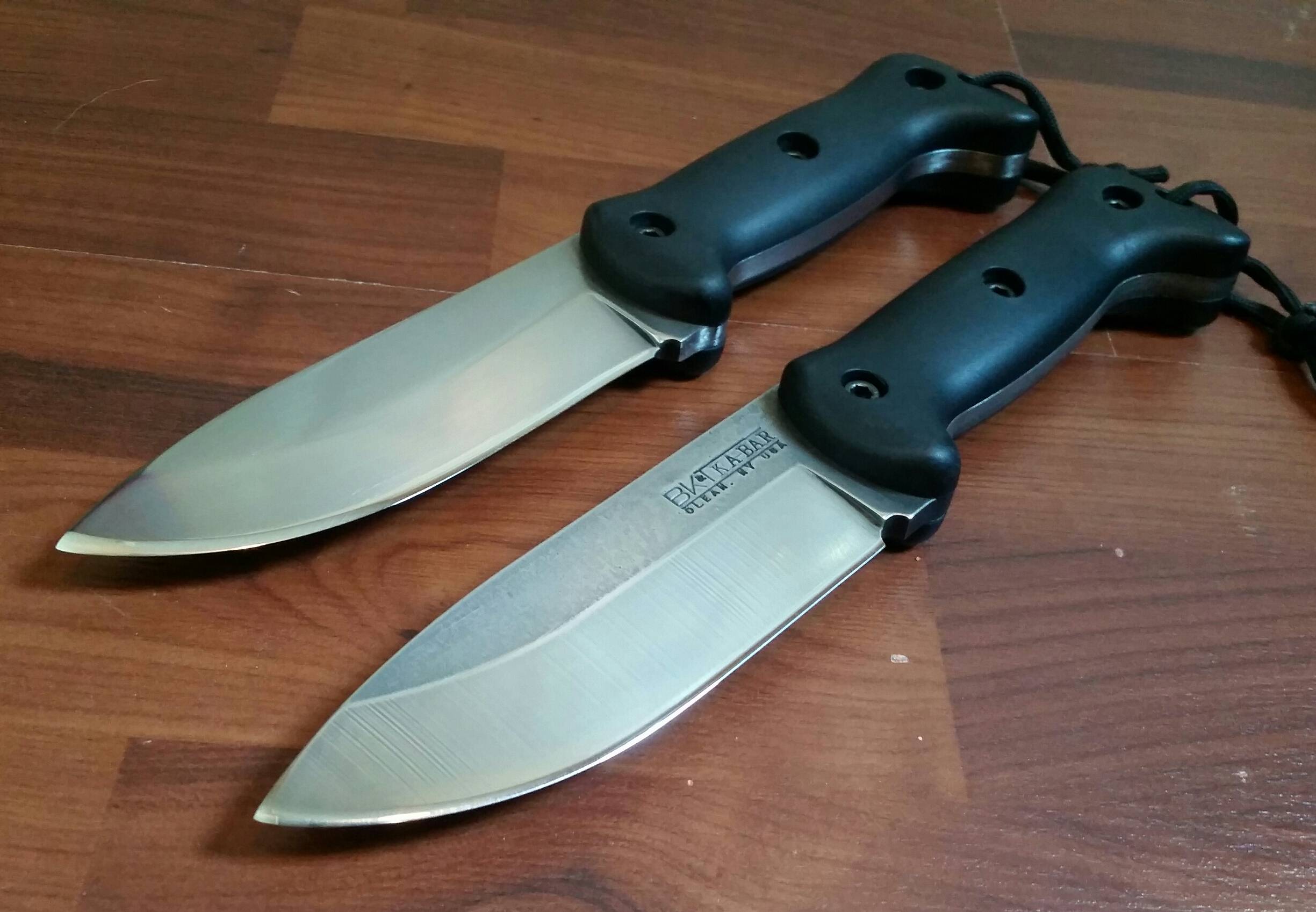

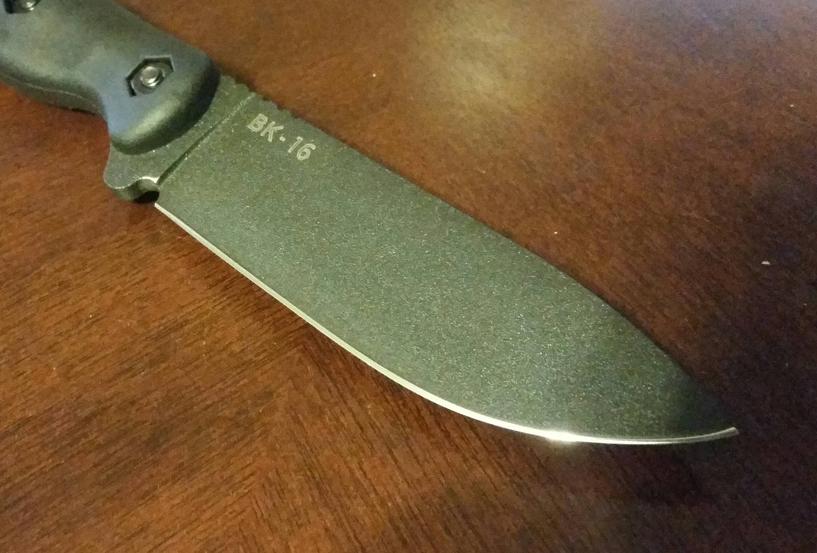

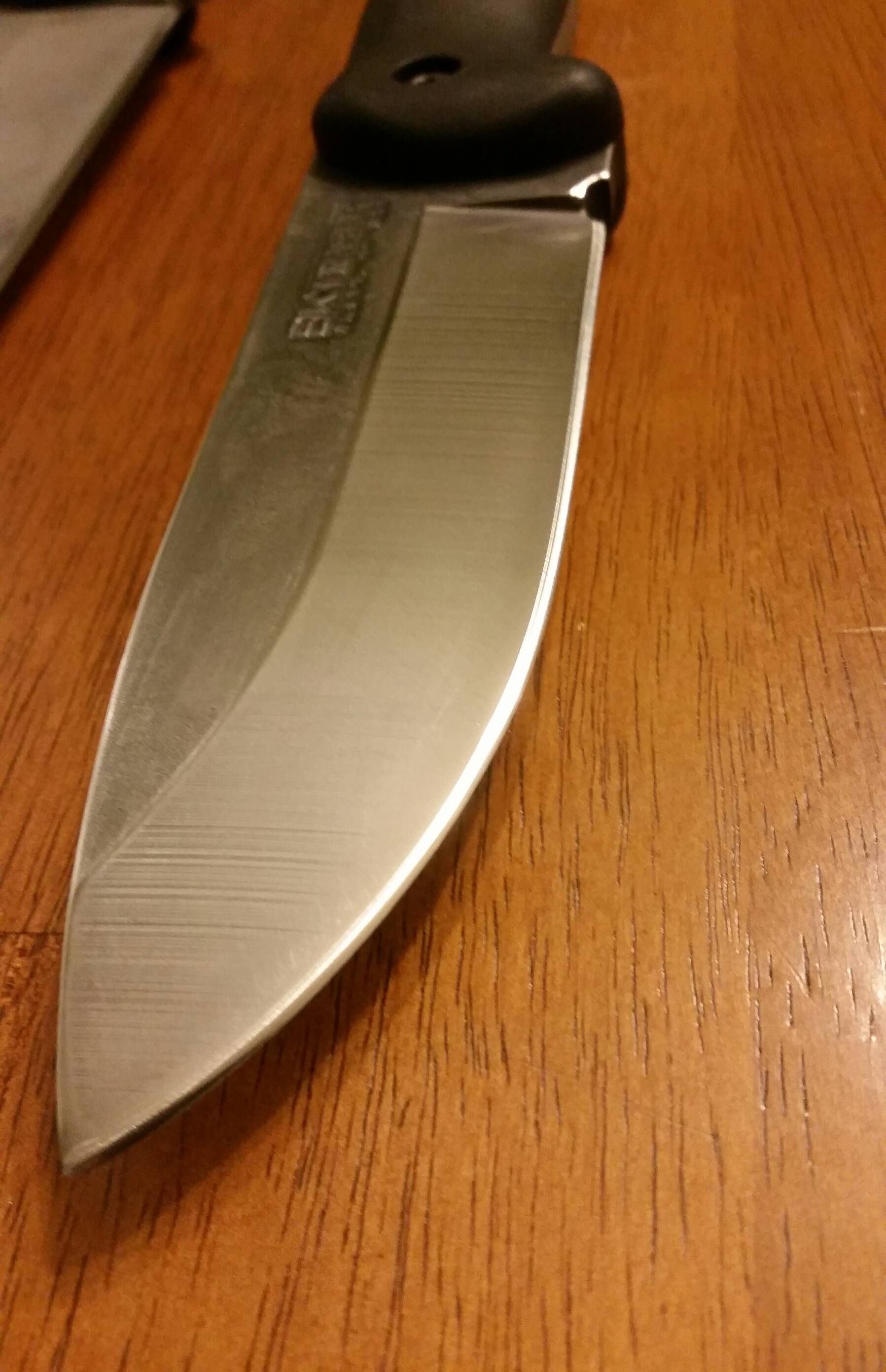

Ok so this isn't a Becker, but the factory edge on this thing was far worse than any Becker you'd find so it shows how well it works. I'll try digging up my Becker edge pix.
Beckers added.
