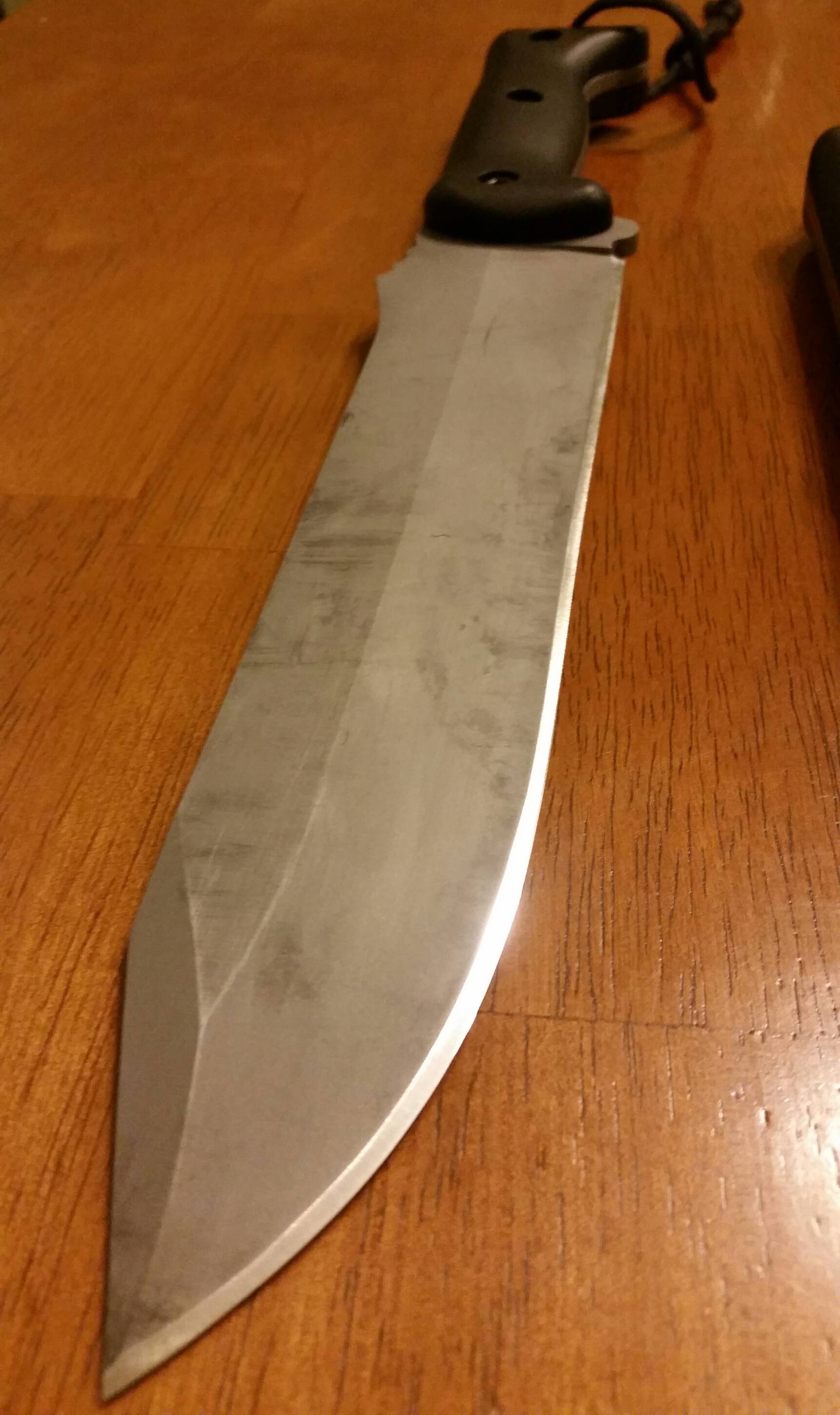

Doing some reprofiling on my bk17 with the work-sharp onion edition
Wow, Kentwood! How long did that take? Did it heat up much? Water dip?
Took a while, didn't wanna be to aggressive, since just started using it, but I think better gonna improve skills with a couple cheaper ones first!
Just curious why you're amazed by this? The wskt-ko makes reprofiling the edge on most knives ridiculously easy, and fast. On thicker stock it doesn't really heat up too bad unless your doing some serious steel removal, and then a quick water dip is all that's needed. It will heat up thinner knives allot faster thou, so those will need dunked in water more frequently.
Amazed = I have one, but since I've never used the more coarse belts. Always fine or polish grits. It just shows just how much that little piece of equipment is capable of.

Yea it's a very capably machine, even more so when you add in the blade grinding attachment. I'd say grab a beater blade and start playing around with the course belts. However the p220 extra course belt will tear thru steel fairly quickly, I only use that one if I want to remove allot of steel. The x64 belt should handle most reprofiling jobs, it may take a few extra passes, but allows more control.
