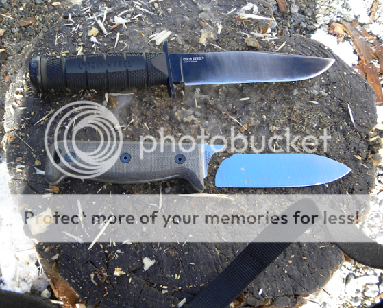

So for X-Mas I got an Ontario BlackBird. I got this knife because the maker claimed you could baton with it. Some state that you shouldn't baton, but as a knife maker, when you make a claim, expect that claim to be tested.
What I did:

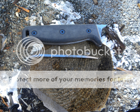

First I baton a few small pieces of wood. Then I chopped for a few minutes. And finally I decided to baton on top of it to see if it could take the hits. I can't stress this next part enough, I put about 1/5 of my normal power into these swings. My normal hits on my CS LeatherNeck have never caused me issue, and with all my might I could not break my CS LeatherNeck. I'm gonna say it again in a different way..........The wood my BlackBird broke on was soft, straight, no knots, hit with very little power and it broke by the third hit.
Here is where it broke.
Here is a picture of my ColdSteel LeatherNeck above the Ontario BlackBird
I'm gonna see if the manufacturer will send me my money back.

from the way it broke, I'm guessing there was a hidden flaw/inclusion in the steel -- Ontario wants it back so they can figure out what happened to the blade.
If, instead of a phone call you had sent them an email with pictures of the pieces, including an end on view of the break, and a phone number to contact you that they might have offered a prepaid shipping label, but probably not.
package it up, include a print of this thread, since it has decent pics of what you were doing and where, and send it to them signature required. This will cost you an extra couple of bucks, but will give you a way to prove the received the knife in case processing your return goes slowly.
good luck.
While I am not an advocate of batonning, it looks to me like there must have been a defect from where the knife broke. It is too clean and right at the "notch" or beginning of the blade edge. I would think that a break there would be from some lateral stress instead of head-on if you can understand my thought process. Perhaps there was some damage from the heat treat process that caused the knife to be brittle at that point.
Hard to know without examining the knife in person. I think the mfg should stand behind their product if they stated you could batton with it. It certainly won't cause them to shut down their business over replacing one knife. Their actual cost of the knife is cheap advertising when used as customer good will and as a testament of their customer service. Keep us informed of their decision. Good luck!
