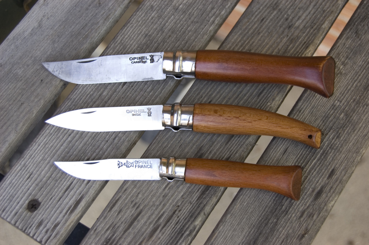

Me? Here's the lame thing I did to mine, which involved nothing fancier than Rit clothing dye and some urethane varnish.
Top to bottom: Opinel #9 (carbon), garden #8 (stainless), #6 (carbon)
It's entirely possible to own one of these things and do absolutely nothing to it. Or you can mess around and have some fun. Your choice!

Oh, those are really nice!
Probably because it's a national symbol of sorts, French knife-nuts really have fun with that thing. I understand (haven't checked) that Opi sells a "rough cut" version, probably in size #8, with all the hardware in place, but handle is left as a rectangular piece of wood with only the blade well in place.

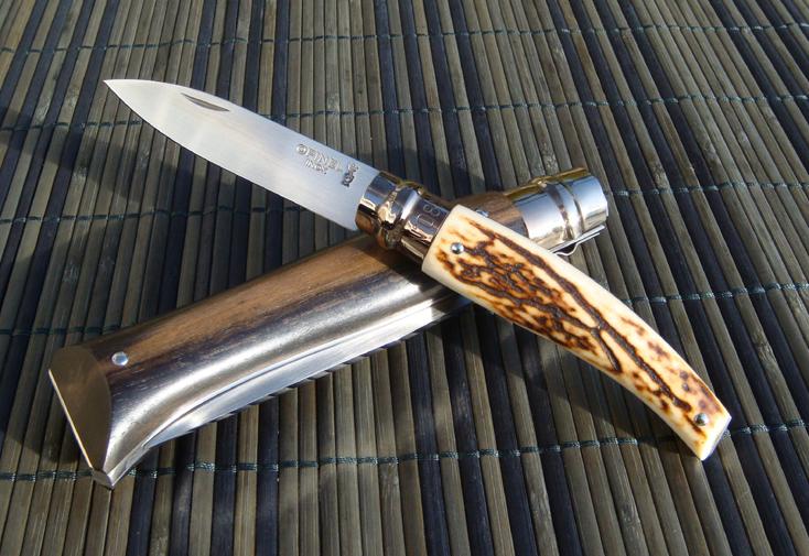

My walk the dog pocket pair. Note I've done a bit of custom woodwork on mine to get to the blade slot more easily. A bit of wax or french polish to keep smart.
Opening and closing is thinking time to how best to get the job done, cut that stick, pick that mushroom, or how to build that baguette to make the perfect sandwich. Life doesn't always have to be in a rush.
