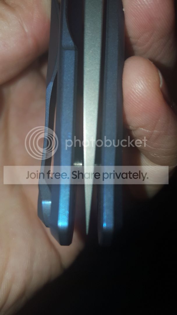

So I recently spent a lot on this knife. Was excited to get it, had a couple cosmetic issues but I got it at a discount. Then I noticed it's quite a bit off center. Would this be a fixable issue or am I just better off sending it back? Thanks.
Lane--It's not THAT bad. You still have good clearance on the sides. Also, it's offset to the side that will keep it from rubbing on opening.
It may just be lock push, too, if the detent is real firm.
Looks to me like the only factor would be how much it bugs you. From the pic it's not necessarily something I'd send back. It may work over in time or you may find you can tweak it back eventually.
But, EChoil, from upper part of the knife, this is actually bad enough. I would not bother if this is a 100 buck knife. If it's has only cosmetic problem, I can accept. But we do not know what has caused this and this may finally lead to rubbering the frame?
My thing is that if the pivot is centered, then I can manipulate or tweak the knife scales, frame , whatever , to prevent rubbing. If the pivot is not centered, then the whole thing is gonna look crappy.

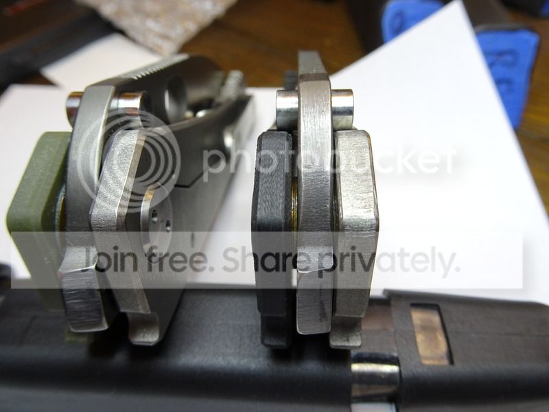

Man I'd be pissed if I spent $400+ on either of those...how does MKT justify that kind of quality control? I'm looking at my seb slabs, and knife grind, and they're essentially flawless.
Sorry for the crappy photo angle. The green knife is actually spot on, perfectly centered. I pointed specifically at the black 187 to show the offset. To add to the furor, haha, the other point I was trying to make with this photo is the lockup wear spot on the end of the blade. Notice the green knife lockup is very early, just as Medford says it will be. The black knife's lockup is 25% or so... clearly demonstrating that this knife should not have left the shop. Why? One, because this is one of Greg Medford's specific selling points, and TWO, because one of the dimensions is off. Either the blade lockup end is too short, or the scale is not right.
So, in my opinion, the guy grinding the angle on the butt end of the blade, went a few thousandths too far. This will cause lockup to be very late. They added the shims to the g10 side to push the blade over to make lockup earlier and assumedly not have to scrap a blade or rework the knife.
And to further bloviate....
The side bar is, the knives are May and July manufacture, 2015, with the green being later. The green knife has larger diameter shim/ bushing stock, more angle grinding on the perimeter of the lock scale. AND.. to be anal retentive , both knives are exactly the same spacing between the scales, approximately 0.230".
Maybe it was an early prototype that slipped through the cracks? It's not just the late lockup on the blade, it's the grind on the side and top of the blade, the grind on the handle scales and the G10 scale, it's completely inconsistent! How did you not send that back to them!?
Read the whole thread, he did send it back and Medford told him, essentially, to pound sand.
Agh thought I had, missed that part. I'd tell them to keep it and then throw a huge fit on BF.
You're not alone. I honestly think DangCat has been impressively restrained and level about the whole thing, as I probably would have gone through the roof if a similar thing happened to me.
No kidding--hope the cats alright! That's ludicrous...seeing something like that is plenty to convince me not to buy any of their knives.
