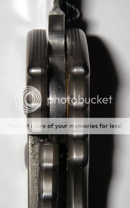

I always worried about a failing lock with a lock up being to early. With my newly acquired seb it's the opposite. The lock bar pretty much almost touches the opposite sides titanium slab. Is this something to be concerned about? It's pretty stiff to disengage.
Is it a new or used sebenza...? CRK spec. is 50-75% but anytime I have asked them about lock-up, they always said as long as there is no blade play, you are good to go regardless of the % of lock-up. But they have also said, it should not touch the side normally under normal lock-up. Sometimes when I use my sebenza and am using a super tight grip, the lock-bar has touched the other side because of squeezing it hard. I have even asked CRK ( recently in fact ) about this and they relied that its perfectly normal and there is nothing to worry about...........If its a well used sebenza, the lock-bar can be re-heat treated and that will lower the lock-up% slightly. Tolerances are super fine as when they mill the blade tang to fit the lock-bar.... .005 is the difference between a 50% lockup and a 75% lock-up.

Thanks nyefmaker, the lock bar covers 95%-100% off the blade. It doesn't have any blade play but is very stiff when disengaging. Probably not worthy of sending it in, right?
If it is a well used sebbie, take it apart and mark where the blade hits the stop pin, then spin the stop pin about 25% so that it hits a different spot and see where it locks up.
As nyefmaker states the slightest change can move the lockbar from 50% to 100%
If that helps then just mark the stop pin so that you can get it put back together the same.
As for the sticky lockbar that is quite common with the regular models, you can send it in and have them look at it, I had to send in a few of mine to get them "unsticky"
They remedied it and the turn around time was about 10 days at the time.

It is actually quite UNcommon for the 21's to be sticky, I would def. send it in if after you take it apart and inspect it and put it back together if it is the same.

doesn't seem to be any damage, i took it apart and cleaned it a couple times. it doesn't really effect anything other then its stiffer to disengage then my other seb. no blade play, just wondering if over time this will result in an issue?
Personally, I would send it in. 95% is out of spec and as you said the lockbar is difficult to disengage. If you do send it in, be prepared to wait a little while.

Thanks for the pic and responses. I will shoot them an email and go from there. I probably should have asked for a picture of the lock up before purchasing. Wouldn't have mattered I still would have bought it. I love the snakewoods.
I think if it does what it is supposed to, lock up your blade, has no play, then you should be good to go. I don't think it should matter how early or late the lockup is. It should only be a factory if it starts to effect the function of what it is intended to do. I think too many people worry about it when there really shouldn't.

Thanks for the reassurance and responses. I agree with onlooker. Unless it effects the function I'm fine with it. It's a bit stiffer then my other seb to disengage but nothing I can't handle.

Mine is the same 80%, I was worried at first, but it has remained the same after 6month of use. I am wondering if this is the norm for current production. I turned my stop pin t see if could reduce it, but no.
I would like to know is this how CRK change the lock up? by changing the diameter of the stop pin.

No, the stop pin is perfectly round. Only after years of use there might form a flat spot and then if you rotate it can it decrease lockup. Only if there is a flat spot.
Each blade is fitted to the lock and checked for lockup. The lock is not fitted to the blade.
The later it is the more secure, CRK do not like early lockup as Chris feels it is less safe. (under correction, will have to watch the CRK dvd again)
