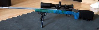

Here's an SN-3 on my 300WM - 3.8 to 22 power ... 58mm objective which is a bit large :o ... I'd prefer 44 now

Now there we go! Badger Max50's.....totally overbuilt and that looks like a Mc. A3......dude....awesome gun. Who built your rifle/ Is it a Robar by any chance?

DrSpine, it's a .300 WM with a SR90 stock, but it's not built by Robar. Jerry Rice (not the football player, duurr :p) at http://www.norcalprecision.com built the gun. He does great work and is local for me.
Those rings are really too much for that .300 WM, and six torx screws for each ring is annoying :o. I'd go with the setup Yuwen has on her 6mm Rem. Scope is a Vari-X III 'Tactical' 4-14x40mm 30mm maintube.
