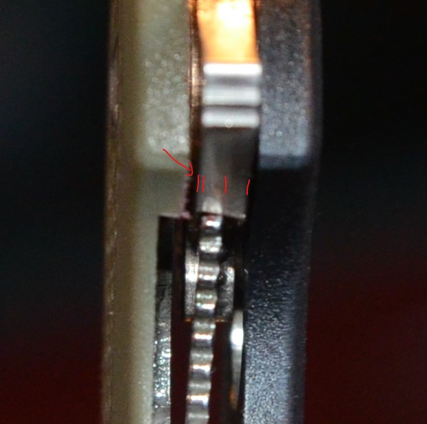

Hi,
I want people that are experienced in working on liner lock folding knives to comment on this. Below is a picture of 3 knives with the liner lock grind to different position relative to the bottom of the blade.
1) The one on the right is the most common when one buys a new knife, ALL of them regardless of brand comes like this. The liner lock is on the far left side, some doesn't even go in far enough to flush with the side of the blade.
2) The middle one I grind so the liner is in the middle of the bottom of the blade.
3) The LEFT one I grind more to let the liner lock almost go all the way to the right side.
What is the reason why ALL the knives come looking like (1) on the right? I would think it is safer to have the liner at least like the one in the middle so the blade is LESS LIKELY TO FOLD BACK DURING USE.
Actually I would think the best is the one on the left that the liner is towards the right side. As you can see, even wearing out with time, the liner goes all the way to the right, it will be stopped by the metal plate(frame) on the right to prevent from going off the bottom of the blade. This should be the safest position in my book.
BUT before I make this conclusion, I want to hear from experienced knife people whether my conclusion is correct, also whether I am missing something that I should consider.
If I am right, it would be so easy for manufacturers to grind the liner to look like (3). Why not?
Please comment.
Thanks
In my opinion, and experience, it's the actual lock-up, not how far the lock travels across the tang that matters most. As long as the lock fully engages (the lock coming to a stop completely within the tang), as long as the knife was properly made (like the tang ground at the right angle), as long as the lock holds the blade securely in the open position, and as long as the knife is used as a knife, and not a prying tool, there shouldn't be any real risk of it accidentally coming unlocked.
The things that concern me as far as safety go are 1. lock-rock/slippage ( tang ground at the wrong angle causing the lock to disengage with slight pressure, and 2. the lock not fully engaging the tang, just catching on the very edge of the tang.
As far as the lock traveling all the way across the tang, I don't like that at all, and if I received a knife like that I would send it back. I want to be able to use a knife for years, if not decades, and I want the lock to have room to wear in over time and repeated openings and closings. A lock that travels all the way across the tang at the very start of its life of service might wear to the point of loosening and cause lock-play.
The liner lock is my favorite type of lock. I've owned and used many. I've been using them for over 20 years, and I've never had one fail or come unlocked on me during use.
The one bad one I owned was a Gerber Applegate "Combat" folder that had lock- rock right out of the box, and would come unlocked with slight pressure applied to the back or tip of the blade. Fortunately I never actually put it to any use.
In contrast, I once used a liner lock knife (Benchmade Darkstar) to pry open a bathroom door when the door knob broke trapping me inside. To my utter shock the lock didn't fail, and the knife still functions perfectly to this day. Of course I don't recommend using a folding knife in such a manner, but it was a unique situation.

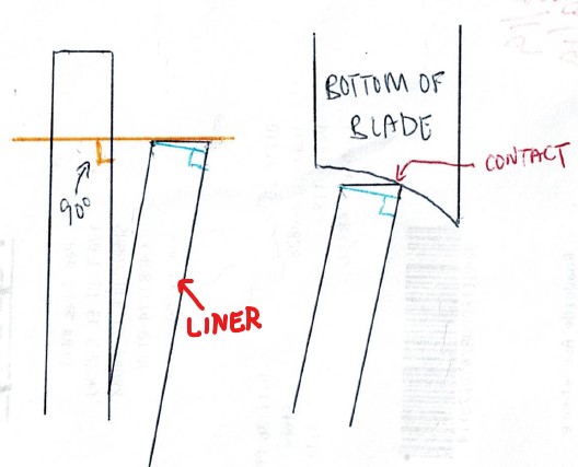

Thanks Killgar,
This is how I grind the liner as shown:
I grind the liner as shown in right that the surface is perpendicular to the frame so when in lock position, the contact is on the right most edge as shown. This will ensure the liner has to be pushed the longest way to the left before it unlock the blade. It should not slip when pushing on the back of the blade.
Even when the contact point wear out, it should not slip, the whole lines just move a little towards the right.
Tell me what you think.
Still, my original question is why manufacturers don't grind it so the liner goes farther to the right. I just think it's a lot safer than how they grind.

I am thinking just make it go a little deeper to be secure as shown in this picture.
I just grind so it's slightly pass the left of the bottom of the blade. So there are plenty of room for wearing out.
I just show the extreme in my first post.
Thanks

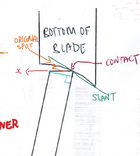

As of the x y, here is my drawing from what I read your explanation.
Do you mean due to the slant on the bottom of the blade as shown in ORANGE, it generate the force in x direction as shown and push the linelock towards the left?
My response is as the linelock move to the left, it will travel to the ORIGINAL SPOT labeled in ORANGE. So that would be no difference as if the linelock was in the original position.
Remember i bend the linelock out more to put more pressure to prevent it from being pushed to the left as easy.
This is what I want to talk, we give our reason and see. I have an open mind, I don't insist on my way. I just want to talk it out like this. If you disagree, let me know.
Thanks for your time.
