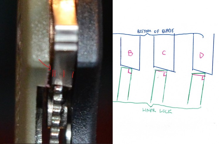

Optimal position of the liner lock

To ensure longevity, I decided to only file the liner so it barely goes deeper than the left surface of the bottom of the blade as show in the picture on the left. So it still have a long way to wear to get to the right side.
The most important thing I did is to bend the liner lock out so it put more pressure towards the right side so it make it harder to being push to the left. To me, from talking here, that's the MOST IMPORTANT thing or safety and reliability. Of cause this will make it hard to open.
To solve the problem of hard to open because of the extra pressure towards the right, I use a diamond bit to flare out the Detent hole on the blade where the Detent ball on the liner fit into. That really make it easy to open, NO DIFFERENT from the original knife.
My question is what is your opinion on the angle to grind on the liner lock shown in (B), (C) and (D) in the drawing. I pick (C) so it's not to steep angle like (D) where it wear out faster.
Let me know your opinion and what advice you have.
Thanks
Alan
PS: The knife is Steel Will with bronze washers, no ball bearing. So there is very little gap between the metal liners and the blade. So even if the liner lock wear so it goes all the way to the right, it will be stopped by the metal liner on the right to prevent it from moving pass the bottom of the blade. I actually screwed up one and grind the liner short enough and travel all the way to the right and I actually feel it is quite secure, no free play on the blade, it won't wear out any further as it is rested against the right liner.

The slope of the tang landing pad allows for wear. It is a self-adjusting mechanism. Hence, why late lockup (the leftward sample in your pic) is inferior. It allows less room for wear and requires more pressure to release the liner lock bar from the tang when closing the knife.

Thanks, do you mean (D) on the right side?
I'm also of the opinion that it doesn't matter where the liner lock ends up, as long as there is no lock rock.
I would focus more on the other part of the lock relationship.

Thanks, that's what I figure.
I actually use Sharpie to paint the surface of the line lock face that are in contact to the bottom of the blade. Put it back together, flip the knife for a while, open it and look at the ink wear mark to make sure the wear is on #3 in the picture on the left.
From the theory of lever action, use the point as far from pivot point(2) as possible.

Unfortunately a liner lock and framelock is not as simple as it might appear. Hence my long replies on the matter.
The book is expensive but worth it if you are interested in doing this on a longer term basis.
What you are currently doing is adjusting the lock to fit the blade, this is not ideal.
You want to clean up the spring/liner, then fit the lock face of the blade to the spring/liner.

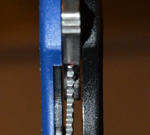

In my opinion the optimal position of a liner lock is all the way against the opposite edge of the blade so that it is stopped by the handle and has to travel the full width of the blade backwards to disengage. That's from a safety standpoint. That's also assuming that there's no significant flex in the handle which would allow the liner lock to keep moving past the edge of the blade.
Of course all locking mechanisms should be treated as if they can fail at any time without warning. They should be regarded as unreliable and not worthy of trust. If you value your fingers. I know that I like my fingers a lot. Me and my fingers are best buddies and I never want to be separated from any of them.
This reminds me of when I first received my Kizer Horn liner lock knife. Had, what seemed to me, early lockup and failed a moderate spine whack. I was not happy. I took apart the knife and began to examine the "geometry" of a liner lock. I came to realize and appreciate the intricacy of the design. As a result, I put away my files and sandpaper. Over time the knife has improved and I no longer have issues, it has worn in just right.

I think if a liner is allowed to travel all the way over to the opposite scale, you introduce more potential weakness in the liner lock.
Since the topic is about strength, I would guess that having the liner less in parallel can cause this.

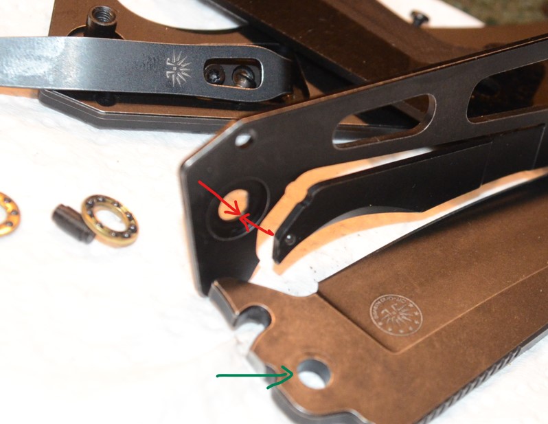

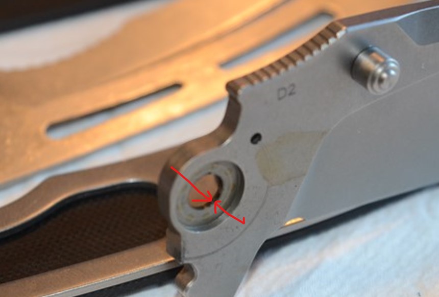

these to me are bad design.
This isKubey KU901. look at the thickness of the pivot hole that is thinned out for the ball bearings. I think it's as thin as 0.03". This can be fixed so easy by thinning out a little on the liner and keep the thickness to about 0.06".
This is Off Grid Enforcer. It's the opposite of the Kubey. they left the pivot hole of the blade untouch, BUT they thin out both liners around the pivot hole, it must be like 0.02" thick. I return this one. It's not cheap but the design. HOW STUPID IS THAT.
You tell me these people know their stuffs?

I'm sure that there are more factors involved than the travel distance of the end of the liner lock. There's the overall shape, the thickness, the composition of the metal, and potentially a heat treat also comes into play. That's off the top of my head.
