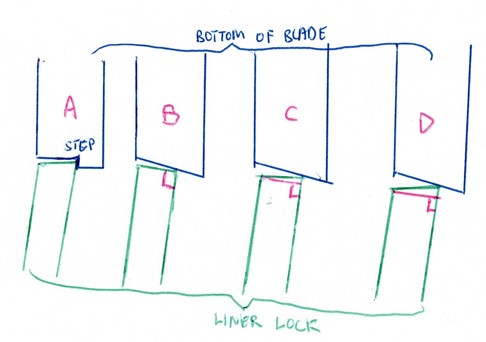

I don't care how easy to close the knife, I make all mine very easy to deploy, better than new when they arrive. I want it to be secure when my life depend on it. That's the only thing that is important.You want to talk about a lot of technical things but apparently not lock rock, excessive lock stick or smooth action.
Yes, the slant, or more precisely the curve, on the bottom of the blade where it contacts the liner edge transfers force in a direction “normal” to the curved surface. Basically perpendicular to the curve, so in the case of your drawing through the 7 o’clock direction. This results in an X direction component like in your sketch (and a Y component too, but that’s vertical). The further the contact point moves to the right along the curve, the normal direction rotates more horizontal and the X component becomes greater. The reverse is also true.Yes, this is what I am hoping to talk, with reasoning.
For the point if the linelock travel more to the right, the spring becomes weaker, this is VALID. I took that into consideration. I actually bend the linelock out more so it put more pressure towards the right in the picture. Of cause that will make it harder to open the knife as the dot on the liner push harder on the hole on the blade that keep the blade from opening.
The fix is I round out the edge of the hole on the blade with a oval diamond drill bit( tip looks like an egg!!). With that, it open just as easy as original but now I put more pressure towards the right than the original knife.
As of the x y, here is my drawing from what I read your explanation.
Do you mean due to the slant on the bottom of the blade as shown in ORANGE, it generate the force in x direction as shown and push the linelock towards the left?
My response is as the linelock move to the left, it will travel to the ORIGINAL SPOT labeled in ORANGE. So that would be no difference as if the linelock was in the original position.
Remember i bend the linelock out more to put more pressure to prevent it from being pushed to the left as easy.
This is what I want to talk, we give our reason and see. I have an open mind, I don't insist on my way. I just want to talk it out like this. If you disagree, let me know.
Thanks for your time.
What you said make sense, that the farther to the right, the more pressure in x direction to push the slidelock towards the left, that once it start moving, the sliding friction is smaller.Yes, the slant, or more precisely the curve, on the bottom of the blade where it contacts the liner edge transfers force in a direction “normal” to the curved surface. Basically perpendicular to the curve, so in the case of your drawing through the 7 o’clock direction. This results in an X direction component like in your sketch (and a Y component too, but that’s vertical). The further the contact point moves to the right along the curve, the normal direction rotates more horizontal and the X component becomes greater. The reverse is also true.
Remember too that the coefficient of static friction Is greater than that of sliding friction, so once it starts moving the force required to keep it moving is reduced. There is every reason to believe that once moving it will pass through the original position and continue, as long as there is a force maintained on the blade.
I missed the part where you bent the liner over further for more spring force, sorry about that.

However, one aspect of the Linerlock is not forgiving at
all. This is the bevel at the end of the tang, on which the end
of the locking liner bears. If this angle is too acute, the liner
will slip and the lock will fail. If the angle is too obtuse, the
liner will stick, and the blade will be difficult or impossible
to close.
Mike emphasizes that there is no single correct angle for
this bevel, as some writers have mistakenly claimed. Rather it
must be determined for each knife. The optimal angle is a
function of the blade and liner materials, of the spring tension
of the liner, and most important of all of the overall length of
the knife. The free end of the liner moves in an arc of a circle,
and the length of the knife determines the radius of this circle.

Unfortunately not.Do you have any picture related to the article linked?
https://www.knife-expert.com/liners.txt
It's very hard to understand just by reading.
Thanks
