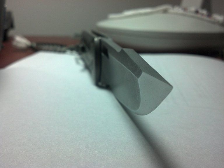

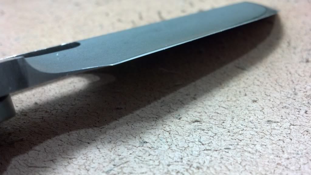

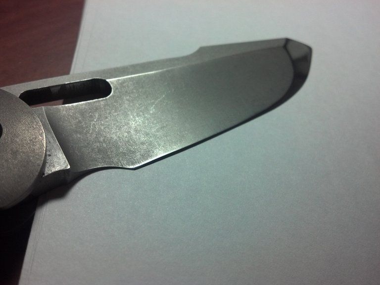

The Horton I have in the pic, although the blade is 0.190" thick, it's a hollow-ground chisel that's 0.010" behind the edge. Even though it's a thick blade, it's a very very fine slicer. The beefy convex at the tip doesn't compromise any strength when stabbing or prying. The thickness behind the edge is thicker towards the tip.
