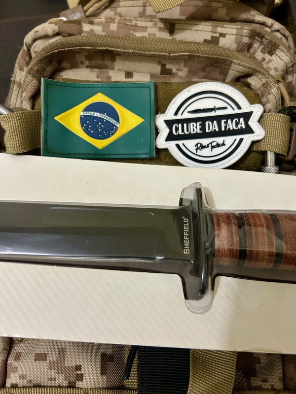

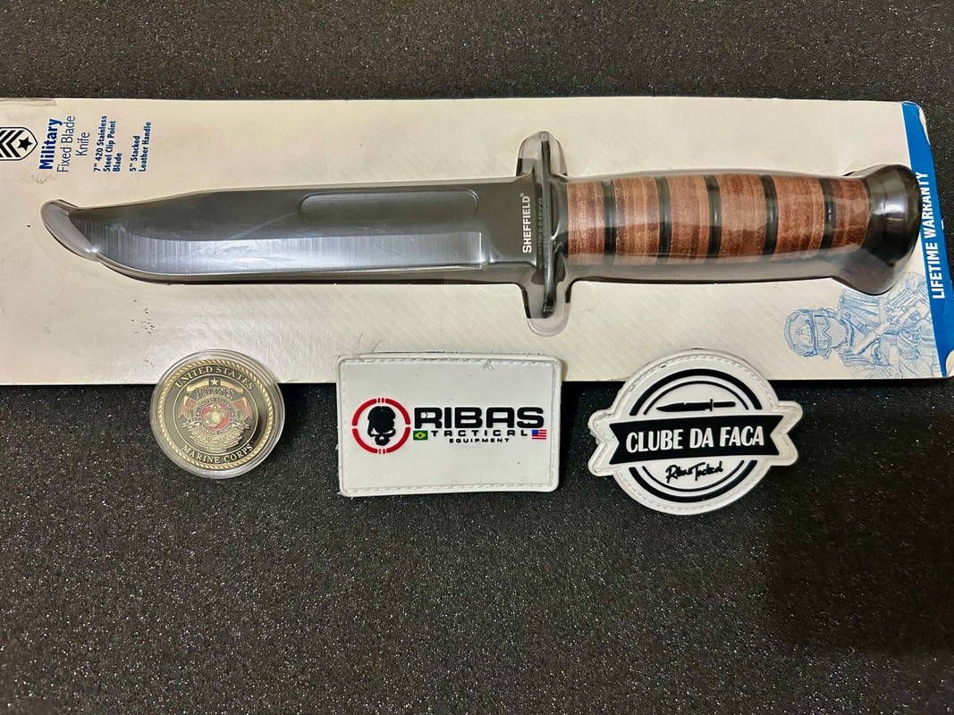

The Brazilian Imbel produced a reinterpretation in the 70s, 80s and 90s. I have the one in the first photo.

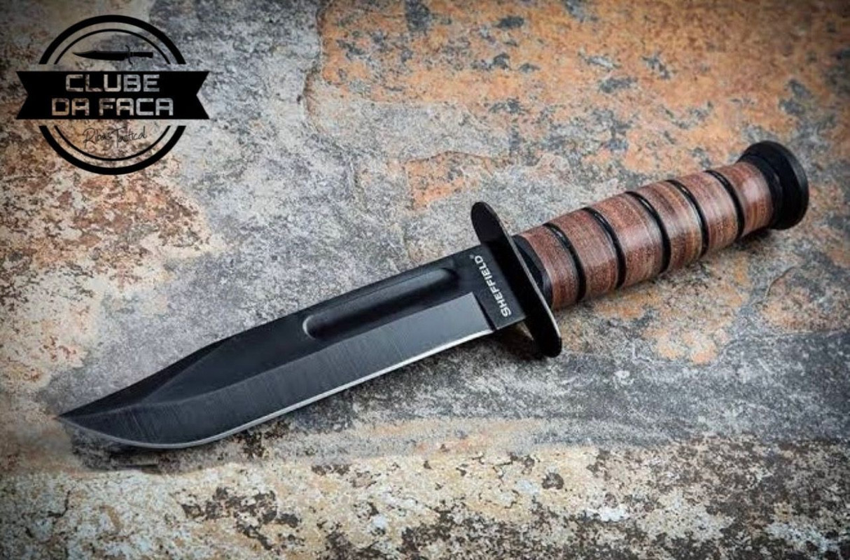

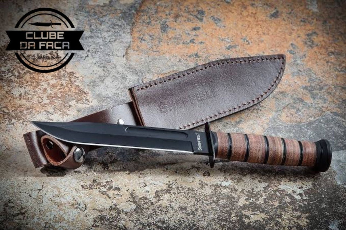

Now I purchased this Sheffield USMC, but I don't know anything about it.
