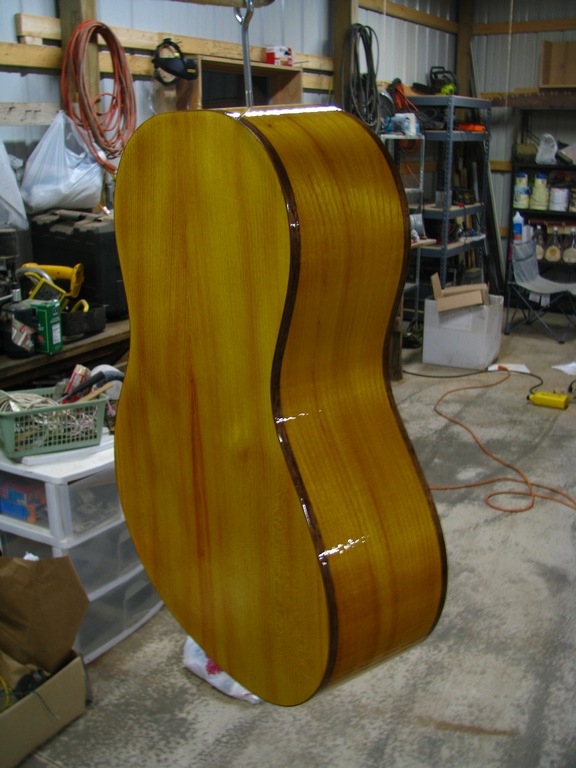

I have one blank, 2 x 10 x 24" here in Acworth, but it's destined for acoustic guitar backs. Good quartersawn Osage big enough for 2 piece guitar backs is rare. Osage Orange physical and sonic properties are a drop in substitute for Brazilian rosewood.
Amen! Here's a couple guitars I built this year with osage backs and sides (the fingerboard on one is also osage).

Too bad it doesn't look like rosewood...
