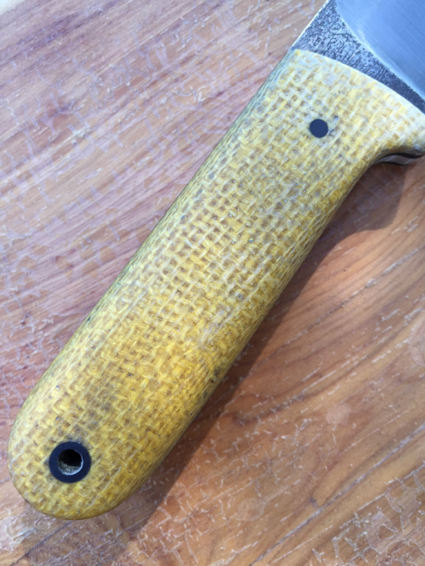

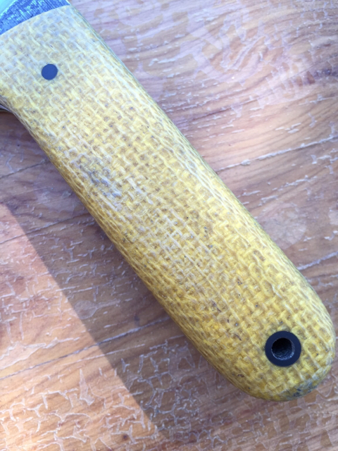

I figured this would be the best place to post this question. I picked up a knife from another maker recently in shadetree burlap. I really dig the knife but the handle seems to need a little more finishing (I'm used to the Fiddleback perfection I guess). The scales have a little black dye from sitting in the sheath and they just aren't as finished or as shinny as I am accustomed to. I don't need any trade secrets here but a little help would be greatly appreciated. I will be hand sanding so maybe a little grit progression and then what is used to finish? I have been really eager to try my hand at anything knife and I know it's a stretch, but hopefully this is just the thing to get me into going a little further. Thanks in advance.

Got a pic?
Working it with 150 grit grit sandpaper, then 220 grit, then 400 grit would be comparable, followed by polishing with black and white scotch brite pads.
Just make sure to wear a mask. Sanding micarta will release formaldehyde as well as hazardous particulates.
I hope this is inconspicuous enough to the maker.
Everything that Triple T said is correct.
We have stopped using 150grit. It was too easy to remove more material than necessary.
Also make sure to use a leather backer on the sand paper. That prevents the pins from becoming "Proud"
Good advice above. The scotchbrite is what gives it that hard candy look. You may just need those steps. If there are deep scratches, you'll need to back up and start at 220 or so. No need to go past 400 before scotchbrite.
