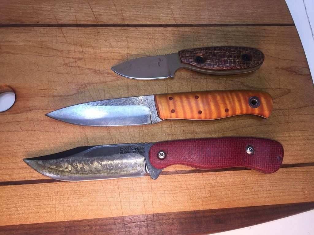

Yea, looks much better now. Looks to me like he tried to belt finish it. generally knives that aren't contoured are belt finished. It leaves a lot to want imo. We get a lot of guffaws from makers about hand sanding. Why, they always ask.
1. Because of the contours.
2. Because I want the scratches on the tang to be longitudinal.
3. Because I don't think the results speak for themselves.
I pay three AMERICANS to sand the handles of the knives we sell y'all. Very few companies do this, and NO production companies that I know of.
Imagine the time savings to make a knife with no contouring and a belt finished handle. I can tell you that in our process 75% of the labor is on the handle. Rounded over un-contoured handle (any assistant can do this rather than me) that is belt finished and we could cut the total labor we put into our knives by half or so. So, why do I do it? What do I tell these other makers? We hand sand our handles because that is what our customers come here for, its what they expect, and IMO, its what they deserve. This might prevent us from becoming a BIG company but damn if I'm going to make 2nd rate knives so that they're cheap to make.
The holes that are inherent in some forms of burlap as a material drives my OCD off the chart. Would it be a good idea to fill them with clear superglue and sand?

always sand from blade to pommel( back & forth), never side to side.Necro!
Phillip pointed me to this one.
Anyone have tips on how to remove small scratches from wood as far as the actual technique goes? Had one show up with some scratches (wood) that definitely need to be removed.
I have 400, and white and grey 3M pads. The 7445 and 7448
don't stay in the same spot for too long
