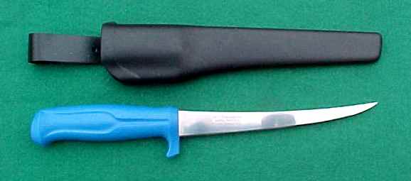

Originally posted by Aardvark
......I'm thinking that the whole thing will look kind of, well, unfinished. Sort of like a face with no eyebrows.
Should I be considering a bolster/guard of some kind? And if so, what material?
Thanks again.
Vark I wouldn't, however I would shape the handle as close as possible to the handles on the Scandanavian knives, at least the two I have.
The handles sort of taper toward the front a little and are in sort of an ellipitical shape, like an egg sideways.
The widest part of the handle is the back or top side. One of my Scandia knives has a well shaped ridge along the top of the handle that's about 1/4" thick and maybe 1/8" larger in size than the area just below it.
This ridge prevents the edge of the knife to come in contact with any flat surface its layed on.
It also prevents the knife from rolling off any flat surface.
The Rapala Fillet Knives are made with a similar handle and everyone knows what they look like, but then again they were made in Scandia too.
I love this shaped handle on a fillet knife as they're very comfortable to use when cleaning a whole lot of fish, cleaned over 50 Crappie with mine one time when I got really lucky.
The Rapalas have a slip over piece on the wood handle at the intersection of handle and blade to make it look better, but I like simple if it's just gonna be a work knife and not for
show.
However "IF" you wanted to do something like it though you could get a copper pipe cap, near the size of the finished handle on the small end, and drill some small holes across the center a little smaller than the blade.
(You could also cut the length off a little if it's too long to look right.)
Then use a small flat file to fit it to the blade tightly.
Then simply round off the small end of the handle to fit inside the cap.
Then when you got ready to assemble it put the JB Weld in the hole in the handle, smear a little around the end of the taped up handle, slip on the cap, slide in the blade and Viola!!!!
Then after the JB hardens a little remove the tape from the handle and blade and use a really sharp fine bladed knife to clean up any run overs and outs.
You can use some Flitz or whatever to polish up the copper to make it look really pretty or just let it tarnish to a nice greenish
patina.
