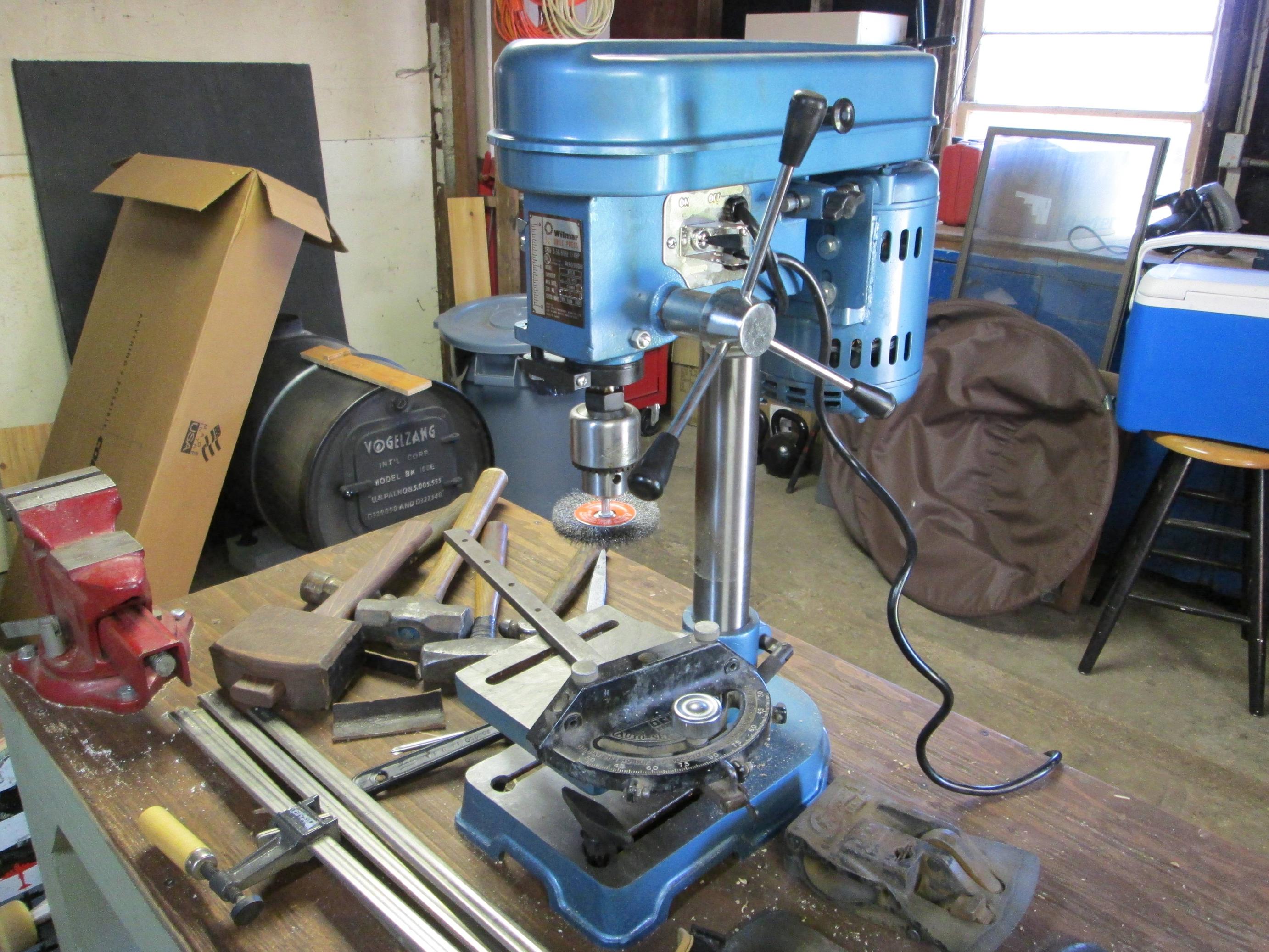

So I have been buying tools to outfit my shop before I get started.

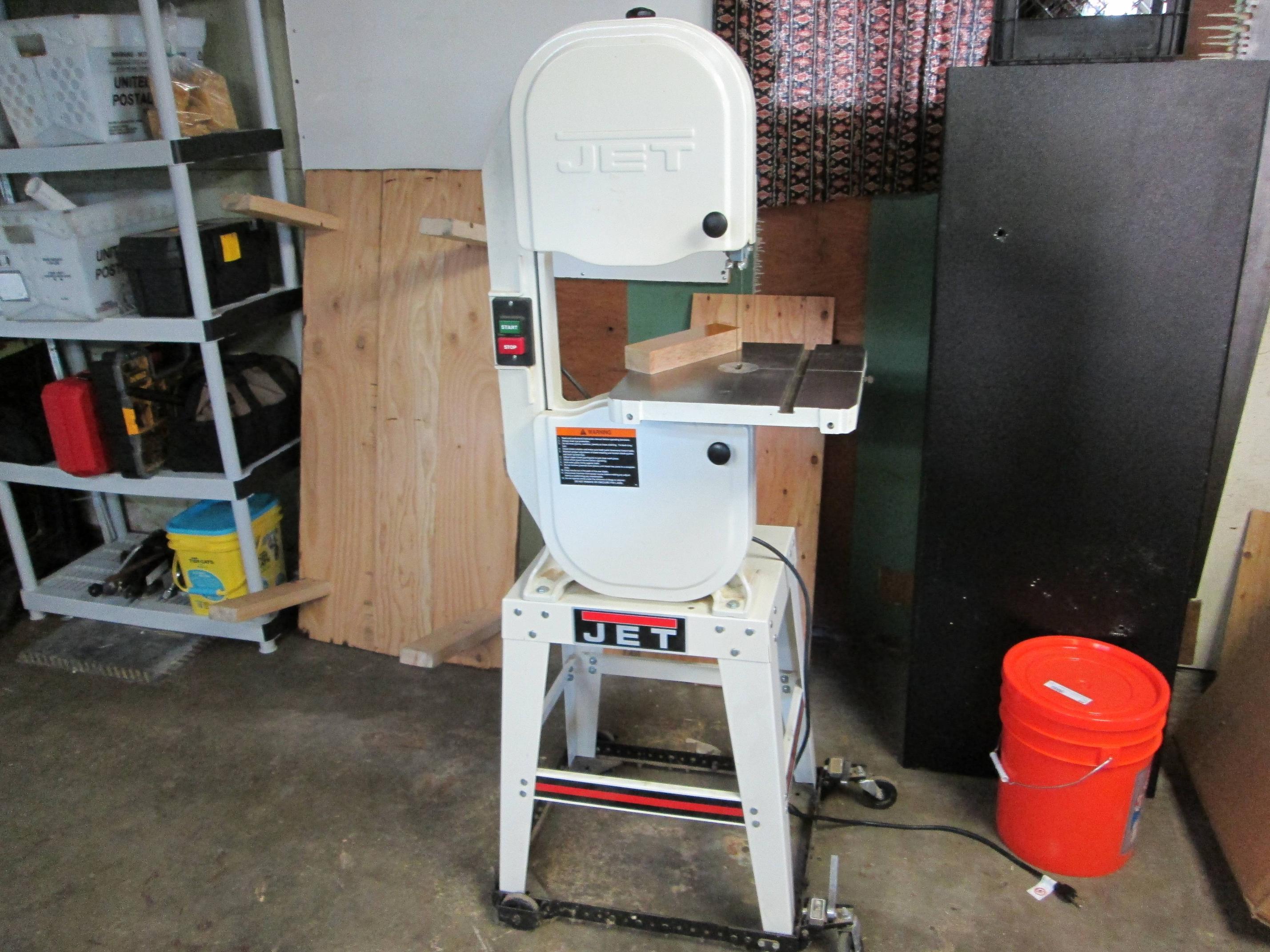

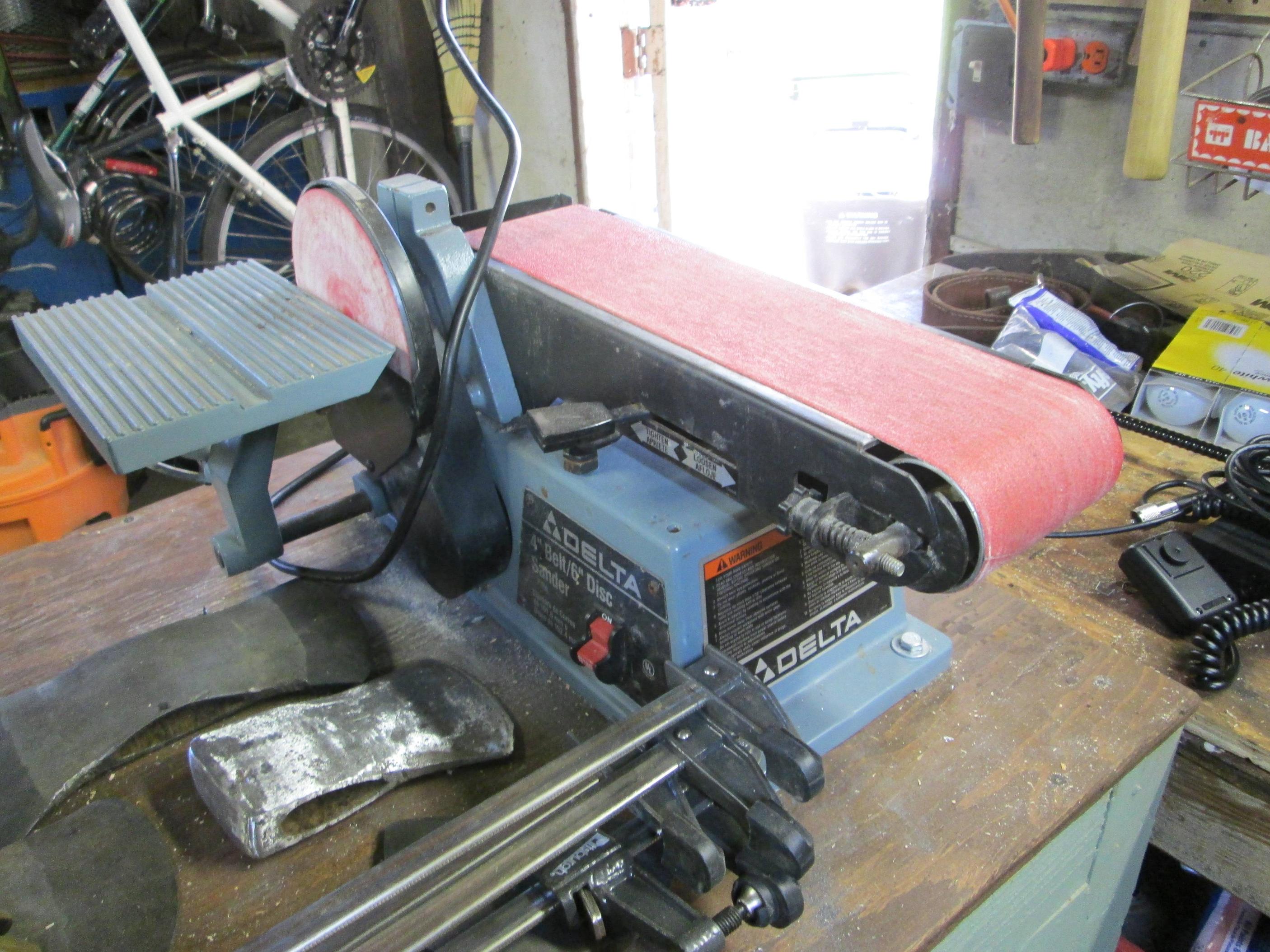

Currently I have a decent drill press, vise, delta belt sander, and today I scored a JET Bandsaw for $150 on Craigslist and all the handtools I would ever want.
My thought process so far has been that the bandsaw would be great for cutting out handle slabs, the Delta sander I have been using to shape handles, drill press is good enough for accurate holes for the handle and bar stock.

What is a good source for bandsaw blades and what tooth pattern should I get for cutting micarta and hardwoods? Same goes for the Portable bandsaw when I get it.

Some messy shop photos!
I wasn't going to chime in here but I had to say nice score on the bandsaw! That's a steel!

Thanks, I had to drive 40 miles for it but it was well worth it I think.

Nice score on the bandsaw! I would only cut wood on it. Leave the micarta and G10 to your metal cutting bandsaw. That stuff is hard and I've seen sparks fly off of it when using my wood cutting bandsaw. It'll dull a good blade fast. As for tooth count, on the jet, for wood I would use a 4 to 8 tpi tooth count. For cutting wood, a high tpi count will cut smoother, but slower. A low tpi will cut faster but rougher. Since everything I cut will be sanded anyway, I use a low tpi and cut it fast.
For metal, it really depends on the thickness of the metal. On most metal between 3/32 and 3/16", I use a 18-24tpi blade. As a general rule, the thinner the metal, the more tpi you'll want. I like a good quality blade such as a Lennox.
Thanks that's just what I needed to know.
