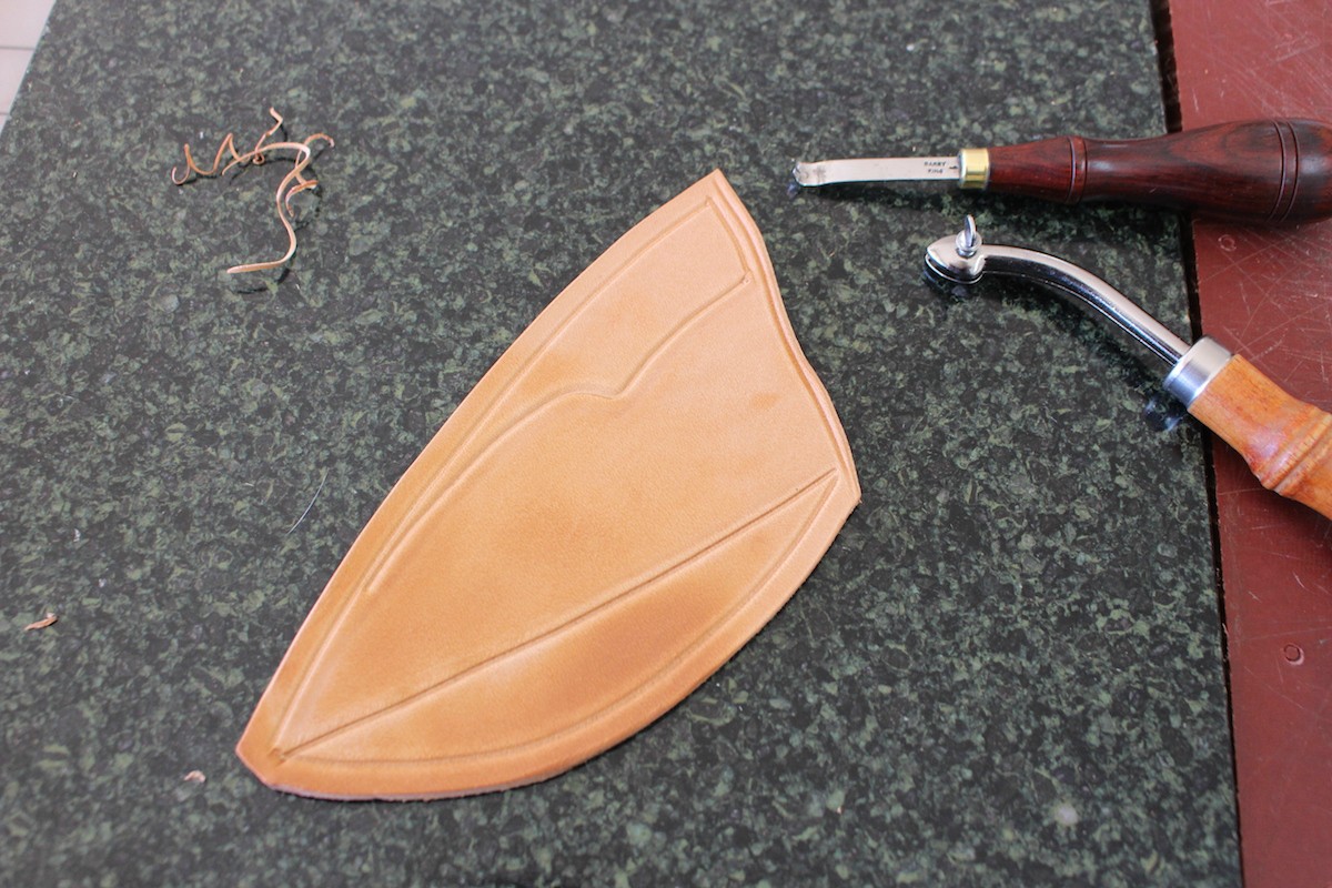

Now I've used two different groovers to get my stitching grooves marked. Both of these are Tandy products I beleive. I've had the red handled one for over 30 years and the other one probably 12-15 years. I keep that one set at this adjustment all the time. It is for sheaths. If I am doing something else I have another groover that I adjust back and forth as needed for that particular project.
Now I've edged (both sides) and creased, (just the top side) of the front part of the sheath. I use a #1 Barry King edger for this operation. The creaser is one that Nichole bought and didn't like so traded me out when she stole my Osborne. I think cresaing is one of those little operations that a lot of folks don't do that add just a touch of professionalism to a project.

Strig buddy, its the red handled tool in the pic immediately above Ken's first comment. Yes I freehand that. I'm trying to stay say a 1/4" to the inside of the edge of the welt which is outlined by the scribed line showing through on the front side. They are stitching goovers and very old so they create a cross between a crease and a groove. Nichole used them the other day and was giving me heck. Asked me when the last time I'd changed the blades on those. Told her I've never changed the blades on those. She has a brand new groover and it leaves a very crisp groove.

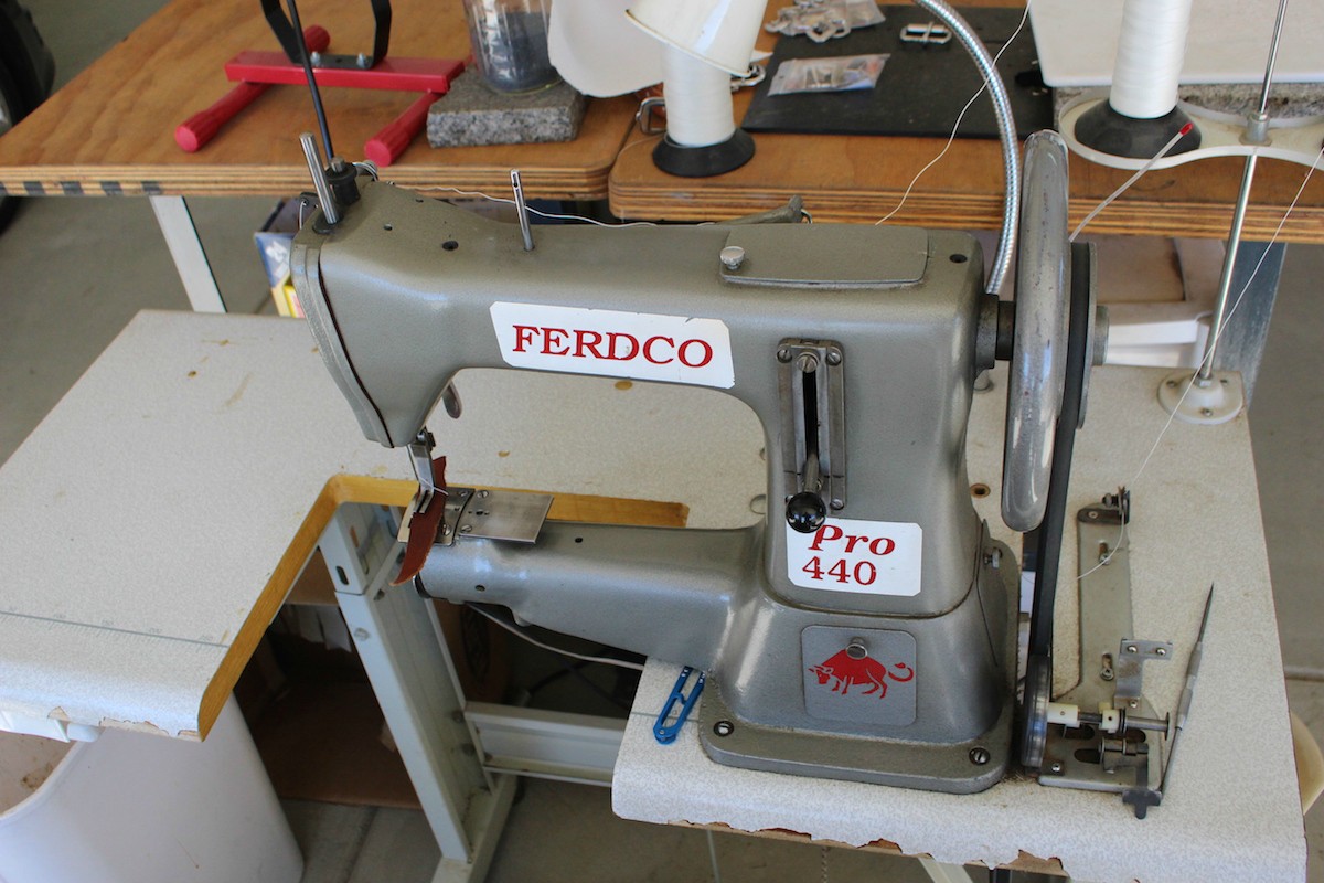

Time to sew. I've had this machine for many years. It a good machine but it had a high learning curve. After about 15 to 20 years I'm kinda getting its quirks down.
Stitching it together. I start on the welt side where the two stiching lines come together. Back stitch the first two to lock them down and then motor on. When I come to the end here I will back stitch two again.
I use a fine tipped soldering iron to melt/cut the strings.
