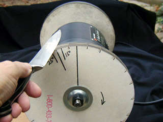

Richard,
I'm really torn right now between trying out a paper wheel setup, the Work Sharp KTS, or an EP or Wicked Edge. I love the results you are getting from paper wheels, but I'm worried I'm going to jack my blades up with not being able to hold the correct and consistant angle. Is there a guide of some sort to help out with the angles?
Richard,
It just takes a little practice. And as for a guide, you need to do two things, hold the blade at a consistent angle and make passes on the wheel at the same spot. So my guide is a simple pointer that tells me where on the wheel I need to contact. I use a rafter square to make sure my reference point is at 90 degrees and then move it so it's right next to the angle marks I put on the wheel. As long as I make my passes where the square is, it's at the correct angle.
Here's how the angles are marked in relation to a reference mark. I do the exact same thing to mark the wheels at various angles, 10, 15, 20 degrees. Following Richard's advice, I practiced on old hack saw blades and some cheap old kitchen knives.

skelt11, like dan says, practice on junk knives before sharpening your good knives. most guys take to the wheels right off but its always a good idea to learn how to hold the knife at the same angle on both sides. i offer help over the phone to anyone in the states or canada that has problems or questions. it saves a lot of typing too and i hate to type if i can keep from it.
a note on guided systems. i used to have an ez sharp which is similar to a lanksy. i'll never go back to a guided system again since its hard to get the knife back in the same positioin you sharpened it at the last time. if you take 2 knives of different widths and sharpen them on a guided system using the same hole or slot and neither knife will have the same angle. in order to measure an angle there has to be 3 points at a certain length. if any of these 3 points are off the angle will be off too.
with the wheels, you hold the knife at the angle you want and you can pretty much match an existing angle easily with plenty of practice or change the angle to whatever you want. you can maintain an esisting edge with the slotted wheel instead of a strop.
with the wheels there are no belts to wear out. grit, rouge and elmers glue are cheap and the wheels last a long time. i have a set that are 20 years old and still going.
