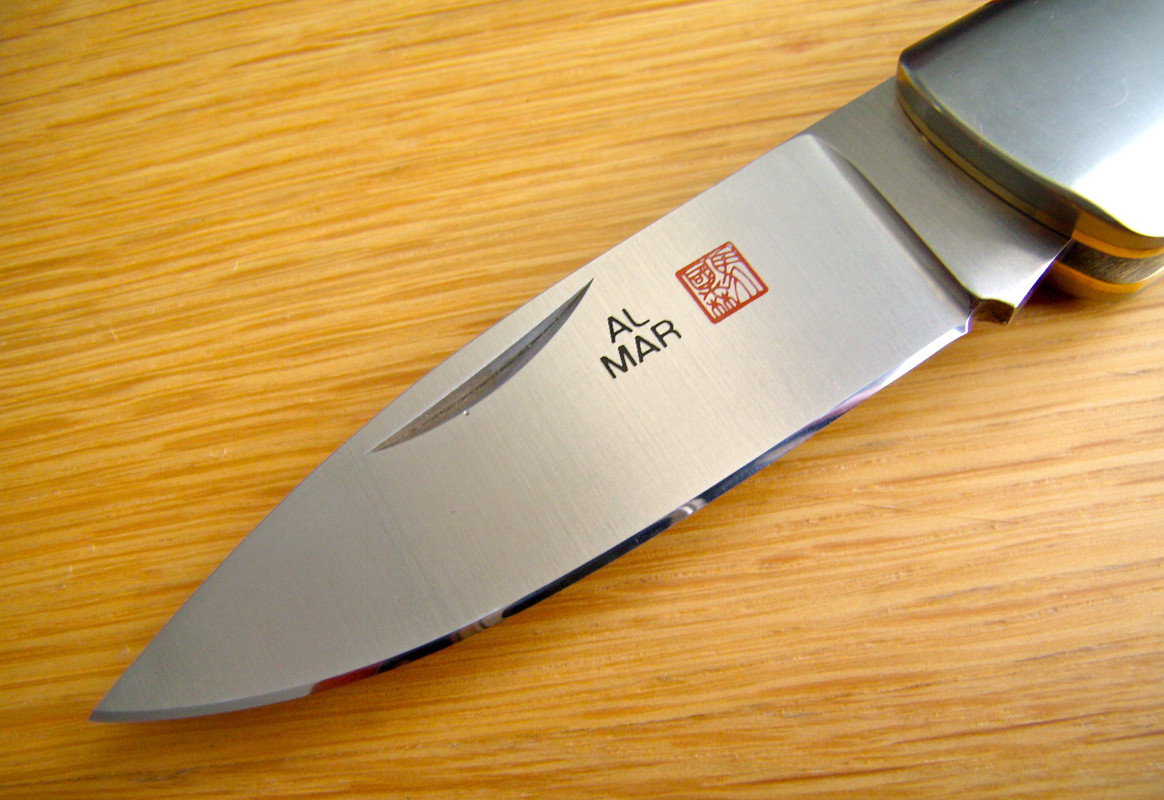

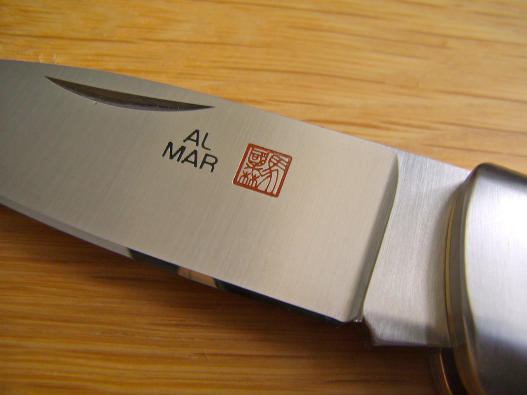

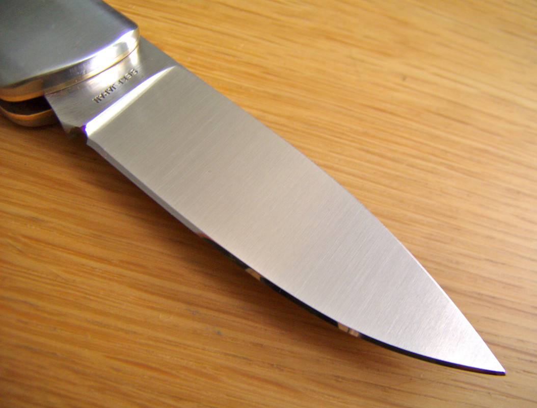

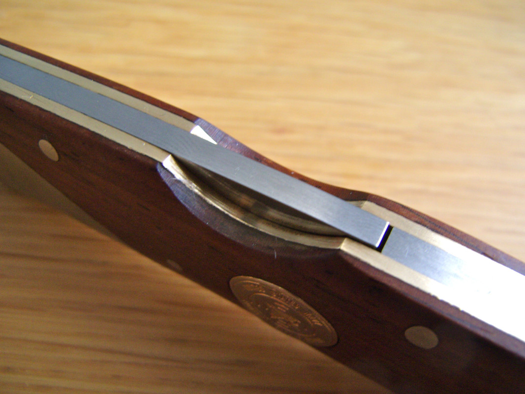

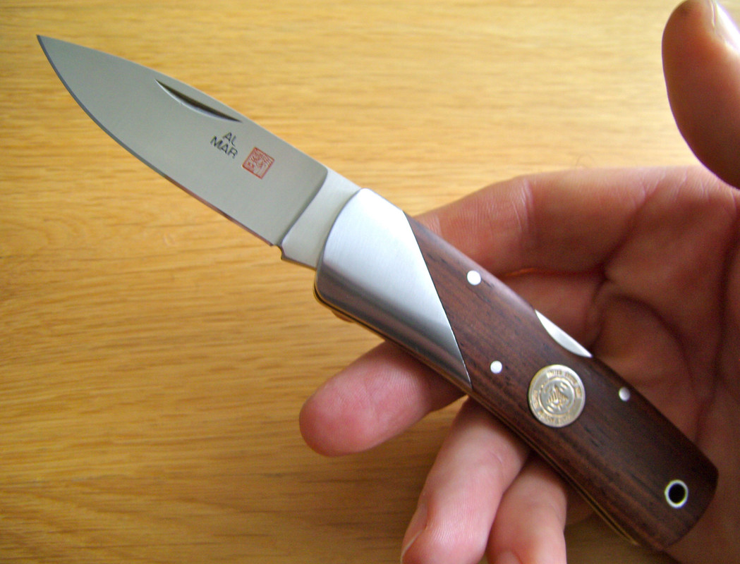

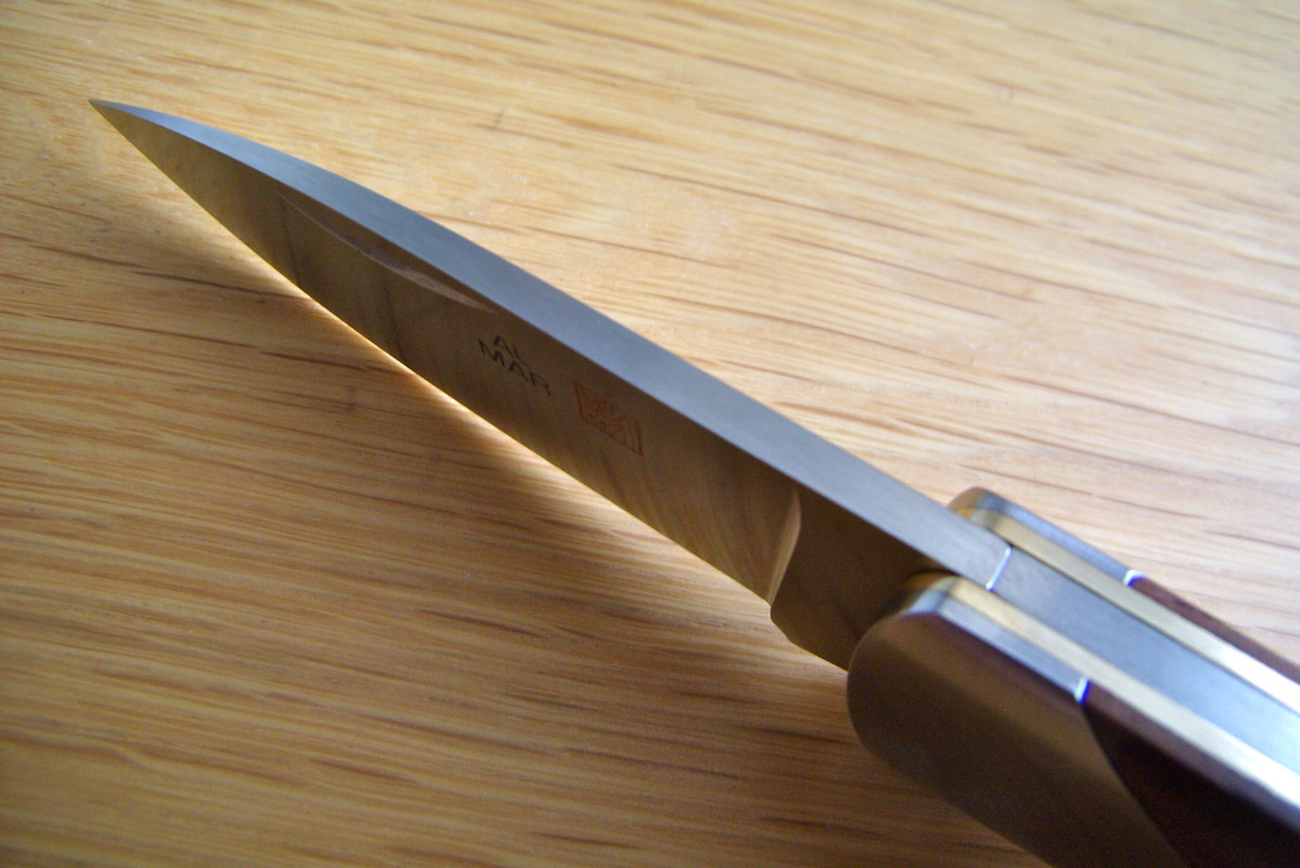

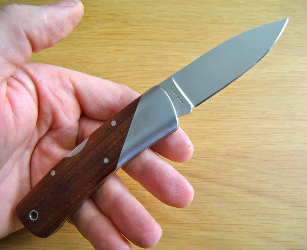

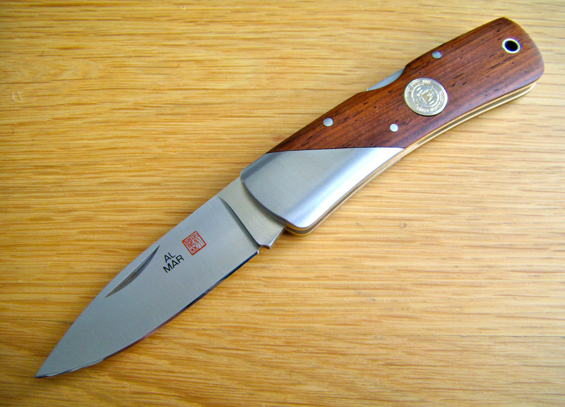

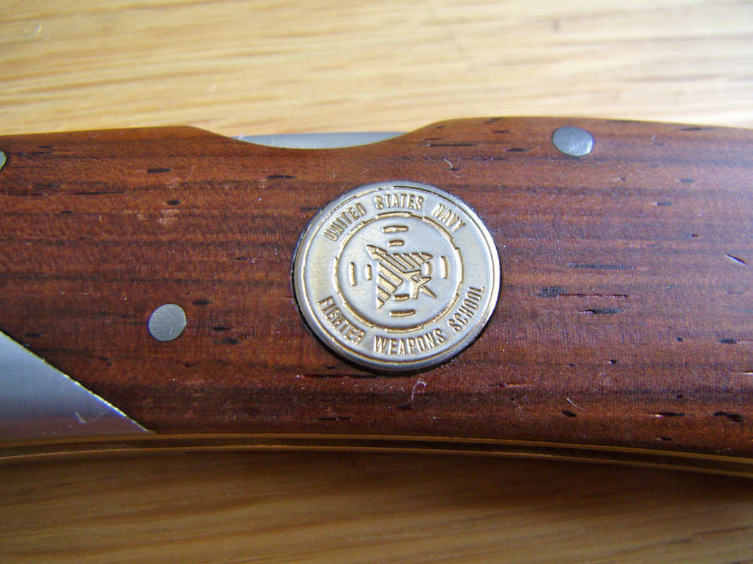

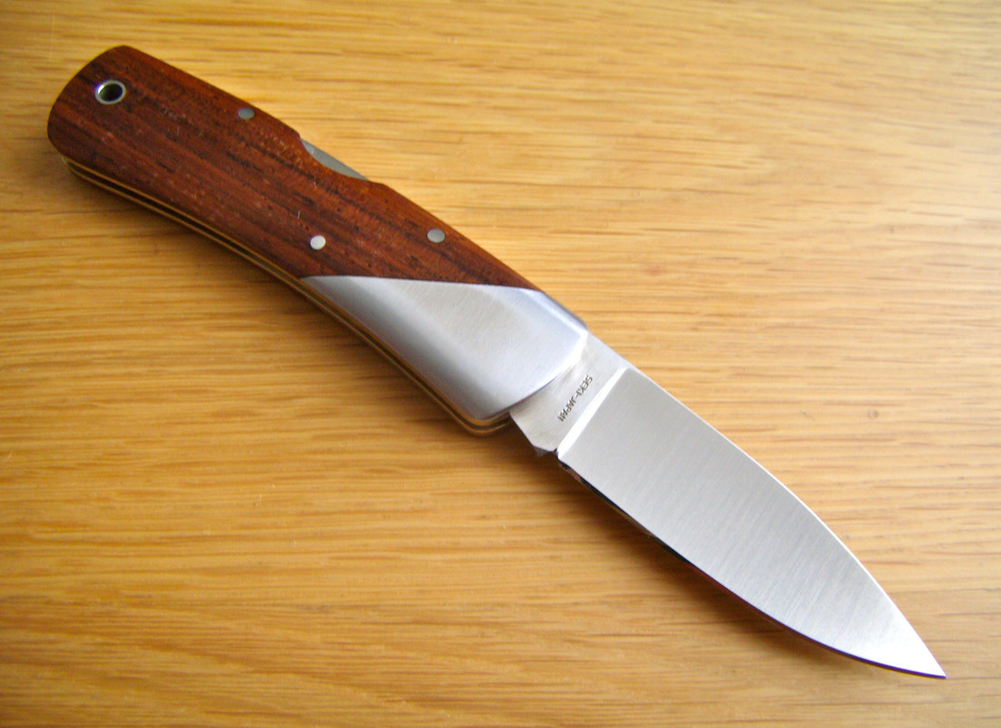

Vintage Al Mar Denali mid-backlock folding knife with hollow ground blade from the 1980's and made in Japan. (probably by Moki)
The cocobolo handle is inlayed with a gold shield picturing a fighter plane and the text "United States Navy Fighter Weapons School".
The 1986 movie "Top Gun" with Tom Cruise and Kelly McGillis was partly filmed on the grounds of this elite school for US Navy pilots.
Bernard Levine thinks this version with the gold shield was a special edition, not standard production.
The original edge measured about 35 degrees inclusive and wasn't really sharp, so i changed the angle to 30 degrees inclusive with a treetopping sharp bling & bite finish.
