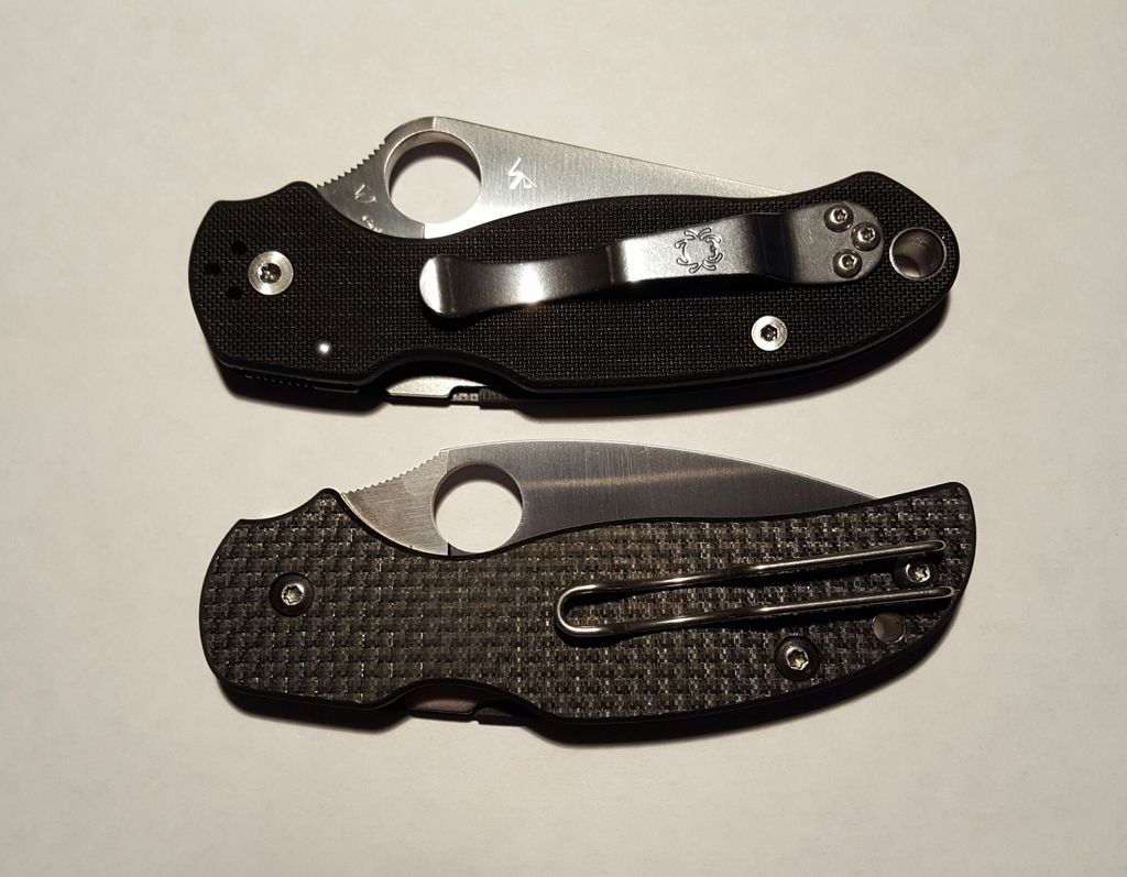

Here's a (bad) pic comparing the Para 3 & Sage 5

I hope Para 3 doesn't overlap Sage 5; they are just too similar, same FFG, same S30V, just different blade shape, and the Sage has peelply Carbon and wire clip... not sure which one to get yet, will have to handle the Para 3 to decide....
you know if you round off the pointy end of the handle on Sage and put the sharp Clip point like Para 3 you'd end up a Para 3 twin. And $15 cheaper
It would be a tough call for me. My first Sage 5 was a bit of a disappointment. The action was stiff and tweaking the pivot a tiny bit helped a lot but it induced a little blade play. I never could find a happy medium. The detent had issues as well. I sent it in to Spyderco and the knife they replaced it with was much better. It might even be my favorite Sage now. Keep in mind the CF isn't peel-ply and is pretty smooth. Still nice though! I love the wire clips too. The Sage 5 is also a tiny bit thinner than the Para 3 and also not as wide.
About the only thing I like better about the Para 3 is the G-10 is grippier (is that a word?) than the CF on the Sage 5. I'm not even sure it matters for my needs but I prefer it. The straight spine on the P3 could come in handy too but again, for my needs, it will probably never matter.
If the price was the same for both I think I would choose the Sage 5 over the Para 3 simply because of the clip location I mentioned earlier.
Not quite a twin but close. Despite being a little shorter overall, the bottom of the handle of the Sage 5 has a little more room. So if you have big hands that might be something to consider.

Until I saw Sharp Guy's pic above, it never clicked in my remaining 3 brain cells how similar the Sage5 is to the Para3. The Sage5 has seen more pocket time than any of my other Spyderco's since I got it. I really like it a lot. Looking forward to the Para-3 coming back in stock so I can get one to see which competes for the most pocket time.
