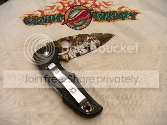

For those of you who are wondering, CPM D2 IS the superior steel. The only thing s30v has over it is corrosion resistance. CPM D2 has better edge retention and takes a very nice edge. Coating it in Mineral Oil DOES prevent the rust, however, as with EVERY steel with the exception of H1, it can still develop spots. There is only 1 steel in the knife industry that claims to be nearly rust proof, and that is H1. Here's a "Stainless" steel for you
